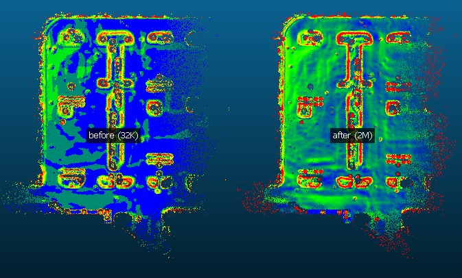

Okay, the issue was indeed the limited number of orientations due to the coding of normals on 15 bytes (which only allows for 32K directions).
I've upgraded this to 21 bytes (= 2M directions) so as to get a much finer result:
You can test this with the latest beta version (I've just updated it).
(of course the result also depends on the way you compute normals - the bigger the radius is, the more uniform the normals will be)

Wow, that really makes a big difference. It looks amazing, thank you very much sir.
