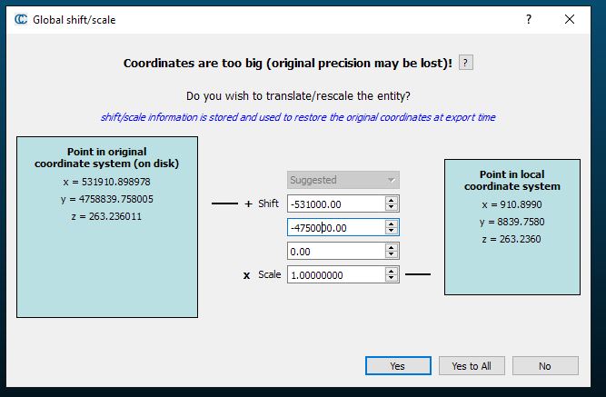

Regarding the offsets, a picture is worth 1000 words. This is a typical setting for me.
Shift and Scale settings
Shift and Scale.JPG (48.14 KiB) Viewed 260398 times
EDIT: Oops! I was too quick giving you a sample. The Y value shouldn't be 8839.758 but just 839.758. I don't remove the 1000's place.
I usually set the file precision to 0.01m and do a 'remove duplicates' to the same amount before applying the scale. With these settings the data should round-trim without a problem, though by the sounds of it I should be saving and loading from you BIN format during interim steps, correct?

And indeed the Global shift parameters are ok.
