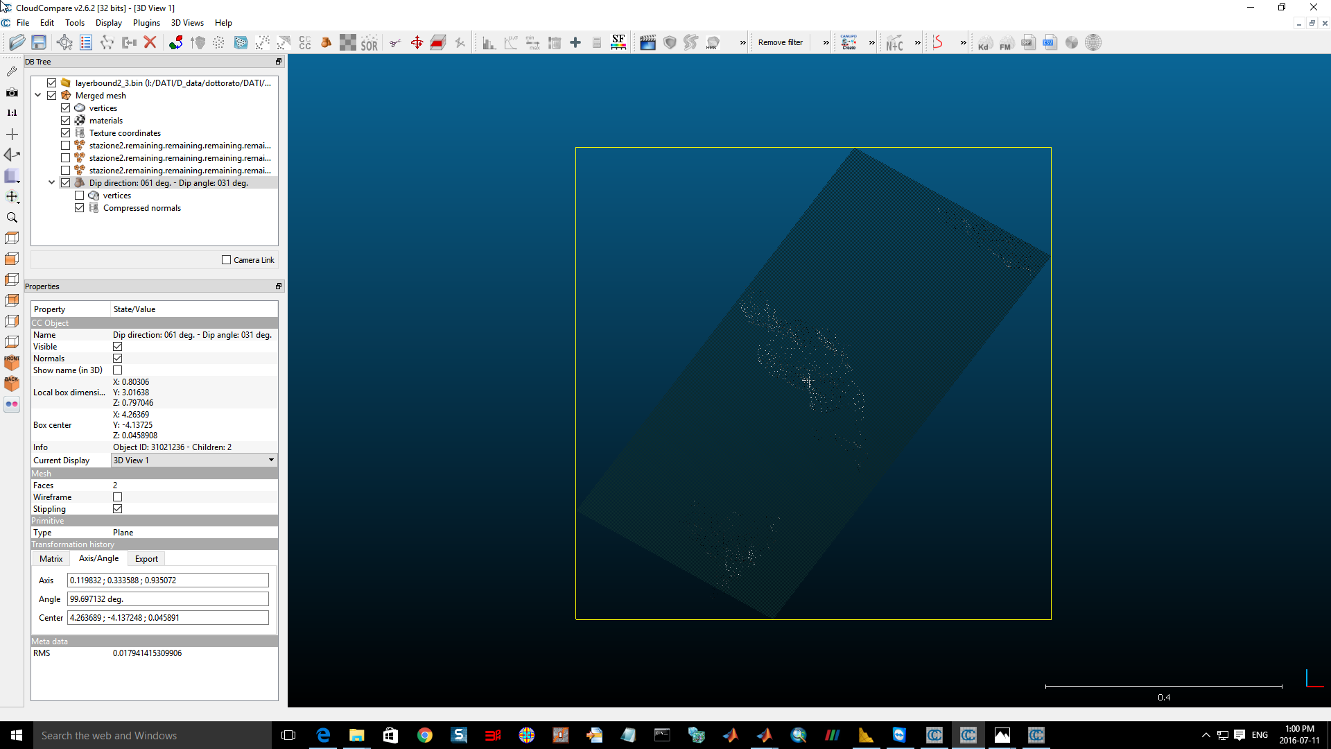

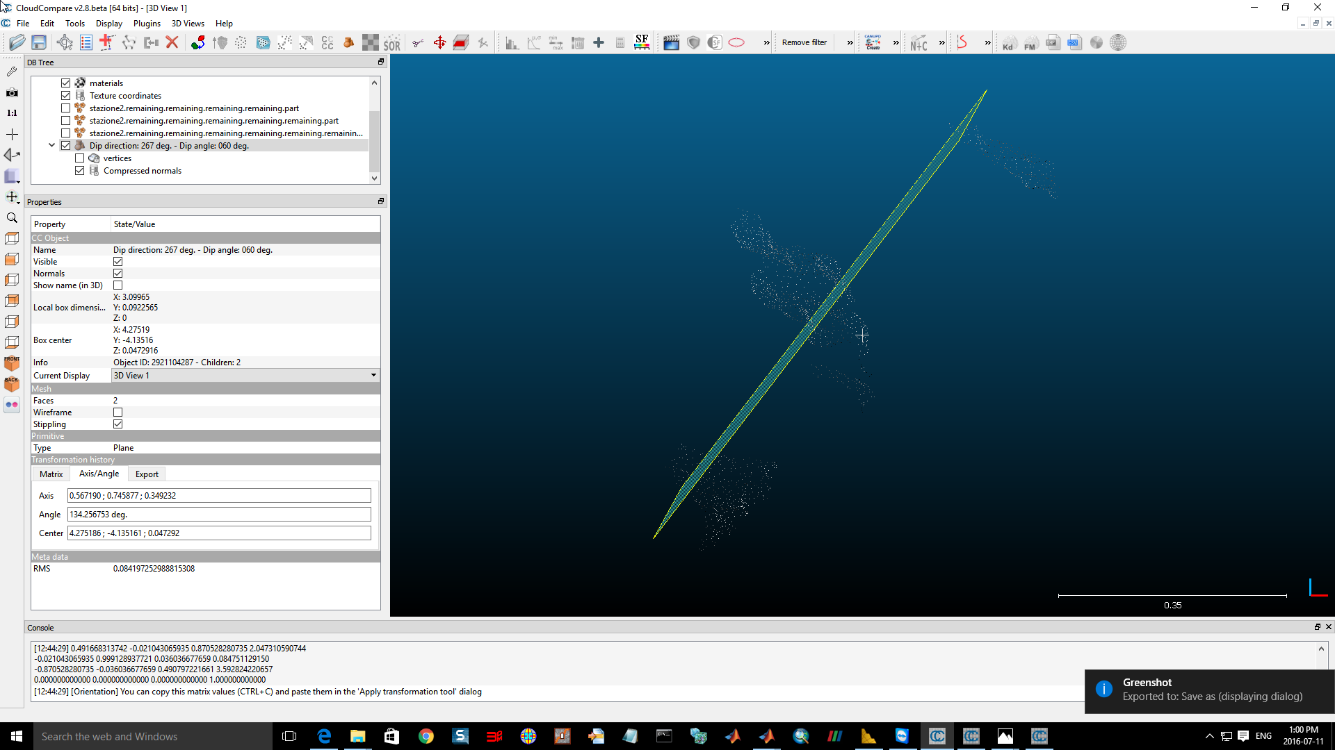

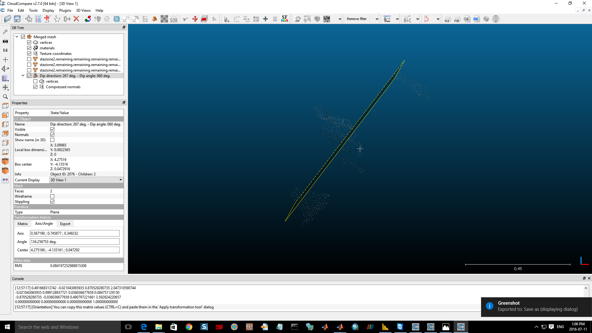

Hello Daniel,
Using versions 2.6.3, 2.7 and 2.8 I have the same problem with the Fit Plane Tool.
When I use the 2.6.2 version the plane fitted is correct, but when I used the newer versions I achieve a plane perpendicular to that fitted with the version 2.6.2.
In general this error happens when the point cloud is circa pseudo horizontal.
I attach some snapshot as example.
Thank you very much
Bye
Niccolo'
Thank you very much
Bye
Niccolo'
- v2.6.2
- 2016-07-11 13_00_14-.png (139.79 KiB) Viewed 13068 times
- v2.7
- 2016-07-11 13_00_23-.png (127.71 KiB) Viewed 13068 times
- v2.8
- 2016-07-11 13_00_31-.png (134.8 KiB) Viewed 13068 times
