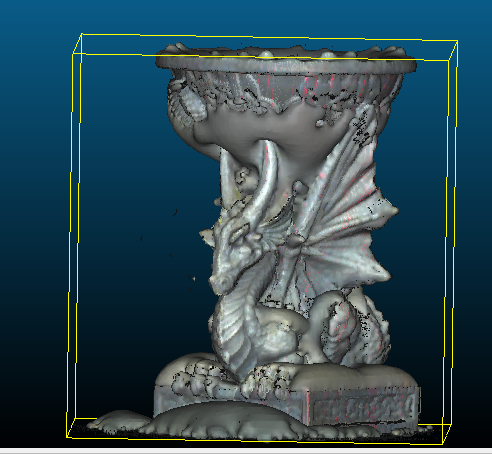

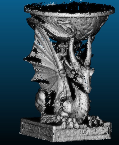

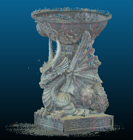

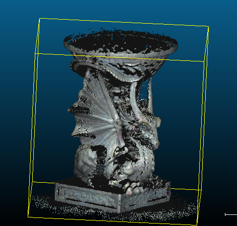

I am attaching a couple of images of my scan and what happens when I compute normals and then using poisson reconstruction.
I haven't cleaned this image before calaculating normals but it makes no difference to my results anyway.

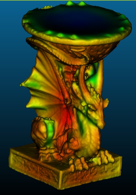

Here is the Poisson mesh (with density information - it can be used to reduce the mesh coverage on low density areas which are either actually empty or noisy due to the lack of information):
