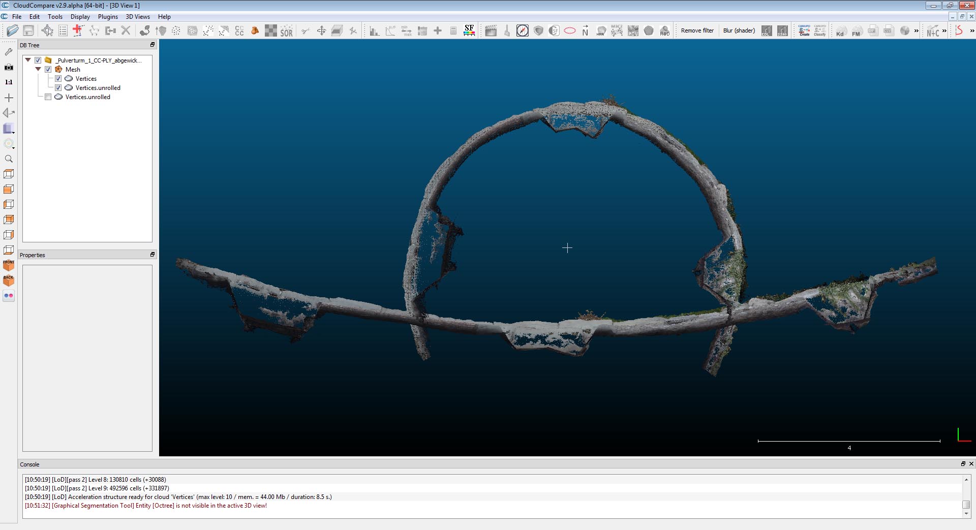

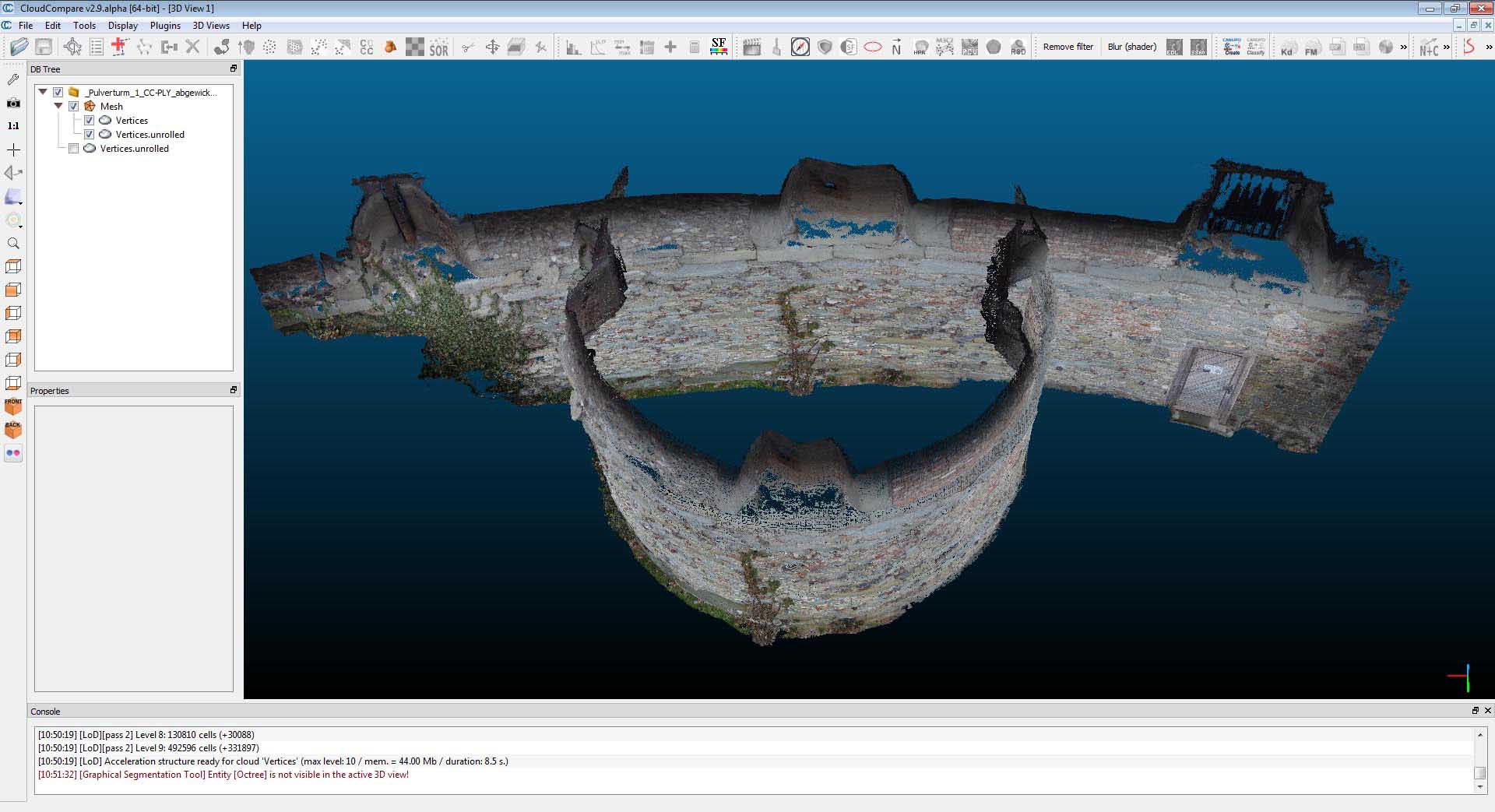

I tried to unroll a cylinder shaped tower but didn't quite succeed.
As is shown on the attached screenshots, the resulting cloud is still slightly curved.
Changing the radius only changed the scale but not the curve.
Deleting everything other than the core-cylinder did not change anything either.
Am I missing something? :-)

Well, several things can explain this, but I think the issue here is probably that the center is not perfectly detected. CC tries to guess it by computing the center of gravity of the point cloud, which is probably shifted in your case as the tower cloud is not complete.
In this case it's better to specify the center yourself.
To do this, you can:
- either pick two points (with the Point Picking tool or simply SHIFT+click on a point) opposite to each other and then compute the center of the segment manually (in the XY plane only)
- or add a cylinder to the scene (with the 'Primitive factory' in the file menu). Set approximately the right radius to this cylinder, and then move it around (with the 'Edit > Translate/Rotate' tool) so that it roughly fit the tower cloud. Then you can simply read the cylinder primitive center in its properties.

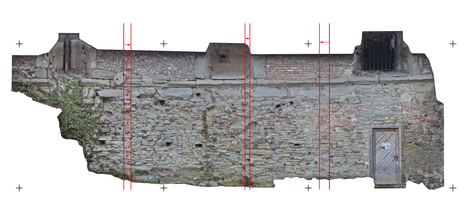

What I mean is that when I unroll the cloud, the horizontal measurements do not at all reflect the measurements taken either on site or in CAD.
Verticals are perfect, horizontals way off.
Even when I adjust the resulting raster image to match the real measurements on the two extremities, in between the positions of features in the cloud vary greatly from their real positions - kinda like the cloud wasn't unrolled on a flat surface but a wavy one. Some features are further to the right as they should be, others too much to the left. Some are more or less correct, but that seems to be random. The magnitude of the deviation is 10% or more over relatively short distances (say 5-10 changes over the whole extent), although not visible to the naked eye.
I tried to visualize it on the attached image. The red arrows between the lines show the real positions an the calculated ones...

Isn't the cylinder axis off here? Or the center once again (even if it's less severe than before)
Otherwise it means that the actual shape of the building is not actually cylindrical and then you won't be able to get a clean result indeed.

Again, you are absolutely right.
I wanted to move the center to 0 but must have overlooked something.
My apologies!
Now, the deviations are only a couple percent, a few centimeters in reality.
And that I can live with, since some error is inevitable with such a procedure.
You might be interested to know that it DID work with the slightly leaning tower, although it is only 1-2 degrees.
Now the vertical AND horizontal measurements are ok.
