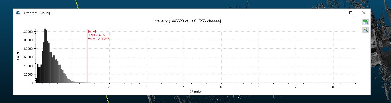

I have some pointclouds with an intensity distribution relegated to a small range, with the exception of some points.
I could filter by intensity, but this way I would loose a small amount of points, not a big issue, but loosing data makes me nervous...
I have not access to the original data, or the tools it has been exported with.
Is there a way to "clip" all the intensities above a certain value (possibly from command line)?
Thanks in advance,
Massimo

There's no such option in CloudCompare... But it would be quite easy to do this with a (e.g. Python) script if you have a text/ASCII file?

Thanks,
I was considering to use a script with it too.
The cloud is in las or e57 format, so it requires an extra step, but it's not an issue. Fortunately the clouds are small.
