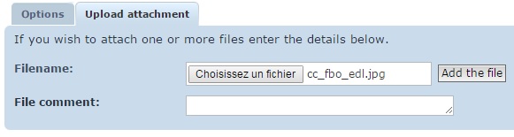

Re: Registering 2 clouds from paired points
When you type a message:
  • click on the 'upload attachment' tab and then on the 'browse file' button.
  • select the image on your disk (then click on the 'Open' button). Make sure the file type is standard (jpg, png, bmp) and not too big (so prefer jpg to be sure ;)
  • cLick on the 'add the file' button next to the filename
  • The image (name) will appear in a 'POSTED ATTACHMENTS' section below the message
The image will appear a the end of the message (you can check it with the 'Preview' button).
Optionally, you can place the image at some particular point:
  • place your cursor in the text where you want to display the image
  • eventually click on the 'Place inline' button
If something doesn't work, you can also send me the image directly (cloudcompare [at] danielgm.net).
