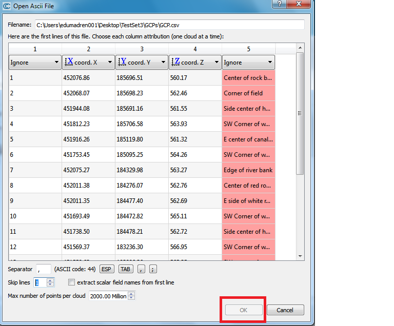

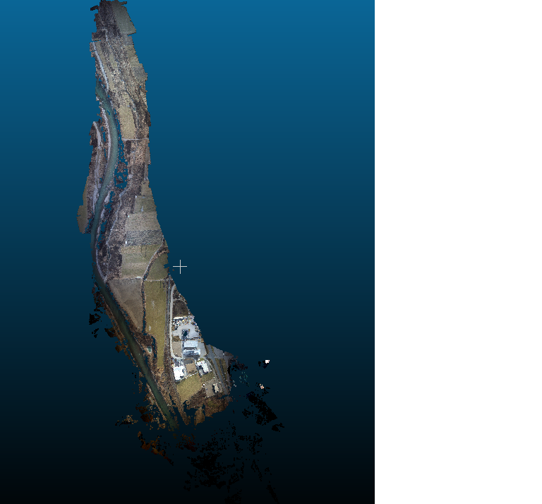

But how do i insert these points on the point cloud? Because when i import these file it is not letting me click on ok.The screen shot is attached here.This shows what is happening.If we notice the image ok button is greyed off.I have the point cloud selected in the background then i am trying to import these points onto the point cloud.Point cloud is also attached.

Oups, I think this is a small glitch (as the column is 'ignored' so CC should let you click on ok!).
Can you simply remove the last column from your CSV file maybe?

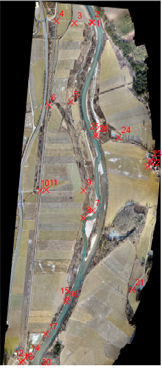

well merge option does not seem to be working in my case.I would like my results to look like the one attached below.This was done using photoscan. All the 26 GCPs are pointed on the orthophoto.
