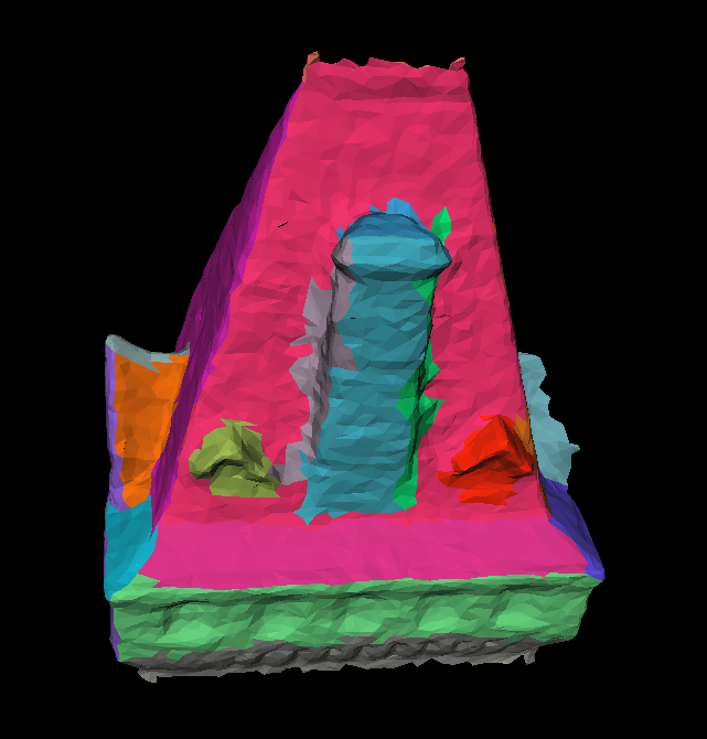

Why not render mesh with triangle color?
vivzqs
Joined: Wed Apr 23, 2014 4:03 am
Post by vivzqs »
just like this
1
1
Re: Why not render mesh with triangle color?
Well, it's actually possible to render a mesh like this in CC. But you need to define per-triangle materials. And the only formats that support this are OBJ and FBX.
Most of the other formats provide per-vertex colors...
