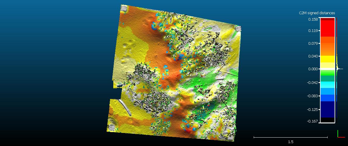

Anyway, until now I have used the M2C tool to comparing the clouds,
I apply the mesh transformation (XY plane, with original normals) on the #Cloud 1 (the oldest one)
but I have noted that some time the response cloud is strange, like in the cloud in attachment:
there are some azure-blue patches that seem to be artifices, mistakes,
because they are on a quite homogeneous accreting zone and the forms too are strange.
Do you know this problem and why?

i'm sorry, excuse me,
i forgot to upload the image!

It's hard to understand exactly what's at stake, but those blue patches are generally due to wrong normals.
How does this mesh has been generated? Can you show it alone? (with normals activated)

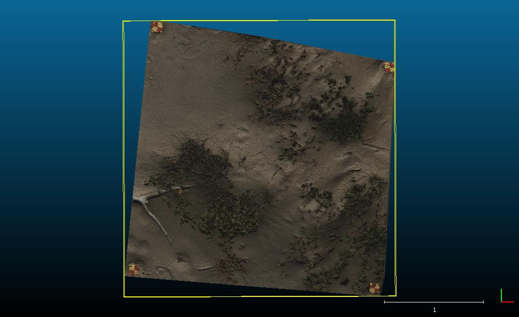

this is the mesh that I used. (Is this? It's correct?)
Usually I use the tool Edit->Mesh->XY plane -> NO update normal
(because when I import the clouds in CC, they are already "cleaned"and "repaired" with Geomagic Studio).
However, I also tried to update the normals and to use "best fitting plane" mesh
but the results are the same.
Maybe I should re-Compute the normals in CC, before the comparison?

Could you post a snapshot (or even better: send me your file) of the mesh alone, and the cloud alone? If the gray (white/black) things I see are part of the mesh, then it looks clearly 'messy'.
