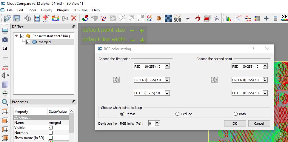

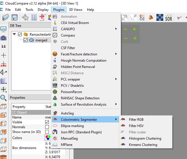

WargodHernandez
Posts: 187
Re: select / delete points by color
Post by WargodHernandez »
We have the colorimetric segmenter for this now
