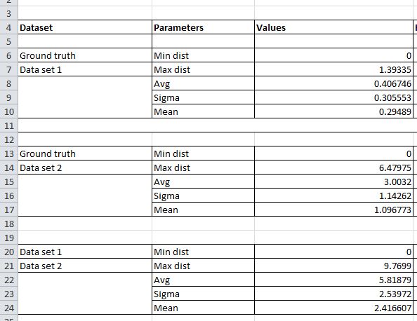

i am having two model generated from different codes and i am comparing it with ground truth of the same object , i am registering them to fit into same scale and i am generating the metrics (max,min,avg,sigma,mean) for the two models , for which i am getting different values of metrics for both models how can i say which model is good based on the sigma value
i have attached the excel sheet of the values obtained from cloud compare , how can i concluded which model is better based on the metrics obtained
Yes i have hit the compute button
i see the colored points , i am using histogram also but not able to come into conclusion based on the histogram
- these are the values obtained from cloud compare
- Capture.JPG (58.93 KiB) Viewed 10760 times
Re: sigma,relative error and roughness for comparision model
I don't think there's a 'standard' way to compare errors. It all depends on your 'quality' crietria. And those criteria should depend on what you want to do with the models.
Personally I generally consider the variance (sigma) which gives an idea of the error distribution (if the distribution is Normal) and the maximum error.
In your case the the first model seems much better.
