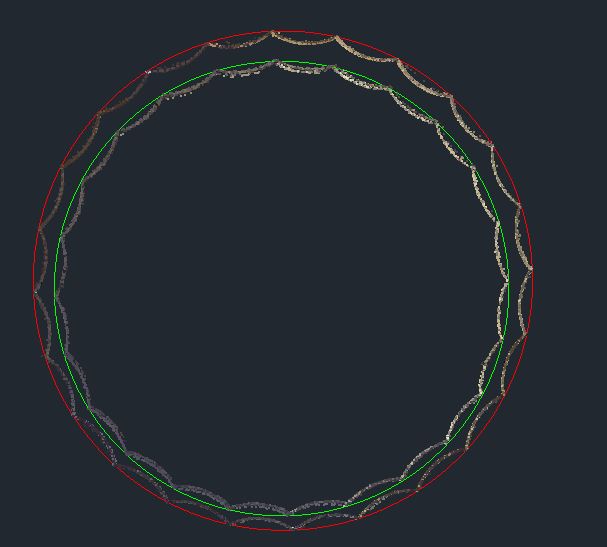

Lower radius=1.8506 m (red in pic)
Upper radius=1.6849 m (green in pic)
Please see attached figure.

EDIT: anyway, the green and red circles don't look very well "centered". Not sure what you'll get. Maybe unrolling this column as a "cylinder" would not be so bad.

Yes, The pillar is not straight.EDIT: anyway, the green and red circles don't look very well "centered"
It would be too much approximation. Don't you think so. I need to do for mm accuracy.Maybe unrolling this column as a "cylinder" would not be so bad.

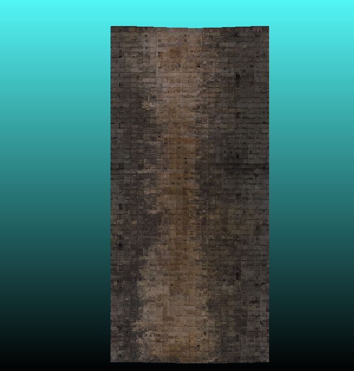

Dear,
I'm trying to use
unroll->cone but still not working.
my parameters are:
center:
Bottom circle : xyz: 0,0,0
Top circle : xyz: 0,0,24.6
radius:
Bottom circle : x,y,z: 1.84 m
Top circle : x,y,z: 1.68 m
Cone apex: 0,0,275 (I just calculated)
angle:0.38
projection radius=1.84 ( WHAT should I give)
I 'm getting unroll with lower and upper edge of same length.
If required, I can send you pointcoud also.
I'm trying to use
my parameters are:
center:
radius:
angle:0.38

Oh maybe that was not clear but this is exactly what the 'unroll' function does (even for a cone). It unwrap the surface as a 'rectangle' .
This is not a 'conical' projection.

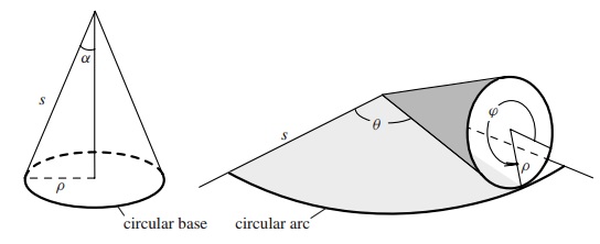

You can look at this paper:
http://www.mamikon.com/USArticles/Rolli ... inders.pdf (page 402)
1) You have first to project each point on the theoretical cone (either orthogonal to the surface or radially)
2) Then you can apply the 'unroll' equation. Let A be the cone apex, alpha the opening angle and P(x,y,z) be the projected point. lets assume also that the cone axis is Z (I'll use the figure notations):
Eventually you'll have to apply a kind of Lambert conical projection (see http://en.wikipedia.org/wiki/Lambert_co ... projection). But is should be simpler (I think theta is the longitude and the latitude is constant in your case. And you already know rho also. I don't have the time to look at the details right now ;)
Code: Select all
s = norm(P-A)
rho = sqrt(x^2 + y^2)
phi = atan2(y,x)
theta = phi * sin(alpha)
