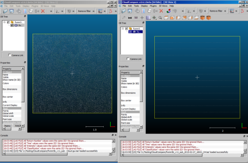

I've been having some fun with command line for processing some .ply files. The first command for which I'm using CloudCompare is to export some .ply files to las. I have some very big differences between the las file that results from saving the .ply as a las file resulting from command line.
Here's my command line:
Code: Select all
"CloudCompare -O " + PLY + " -C_EXPORT_FMT LAS -SAVE_CLOUDS"
Screen shots of the resulting images are below:
GUI las cloud left (normal), command line las cloud right (sparse).
Hopefully we can see from resolution, the las file export from the GUI has normal density while the command line export only captures a few of the points.
Both files are the same file size!
Are there some commands that I can pass to command line to compensate for this issue? Known bug?
Thanks for your thoughts.
Rich
Re: Difference in export cloud density: GUI vs. Command Line
This is a problem due to large coordinates. In command line, no 'global' shift is applied by default. You have to explicitly specify how this should be handled.
Use the '-GLOBAL_SHIFT' option:
