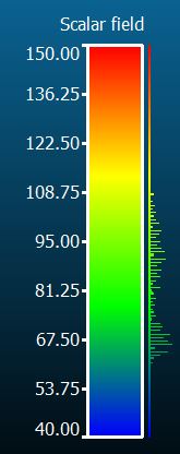

How can I label scalar field with specified number (3,...15) of labels.

I mean that I need 5 labels and not 9..10. Please see fig.

Re: labelling scaler field
Ah! You are speaking about those labels ;)
For now you can't choose them but it is planned to let the user change this in the next version.
