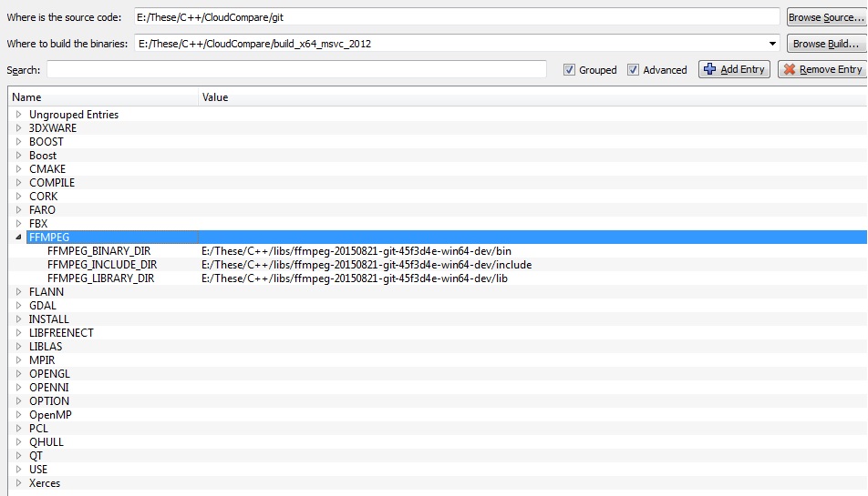

But more importantly, I added an optional support in CMake for FFmpeg (https://www.ffmpeg.org/) to generate movies instead of a series of images.
Simply check the 'WITH_FFMPEG_SUPPORT' option in CMake then set the required fields. I only tested it on Windows for now:
(for Windows, the FFmpeg binaries can be downloaded from http://ffmpeg.zeranoe.com/builds/)
