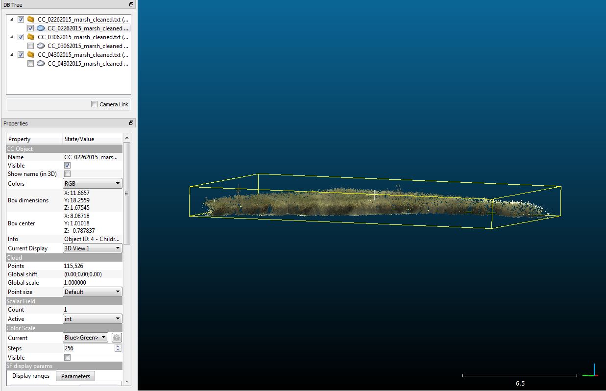

The study site is eroding horizontally (bank erosion). I am attaching a screen shot of our February scan data. I look forward to your suggestions on how to analyze the data.
