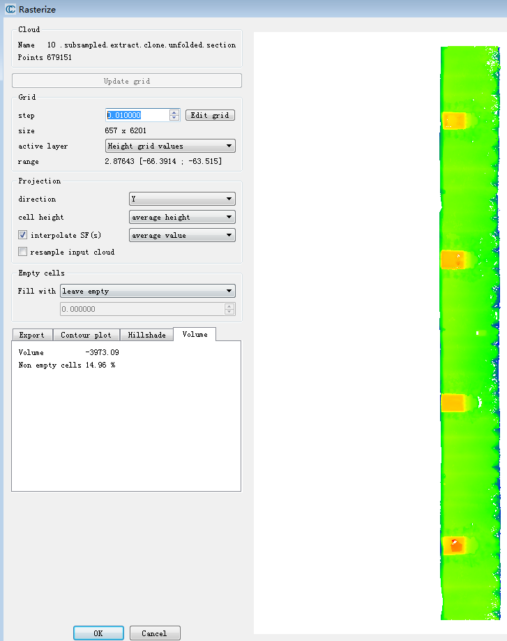

zheng
Joined: Wed Sep 19, 2018 9:26 am
Re: Completeness/Coverage of point cloud
Post by zheng »
daniel wrote: Sat Oct 31, 2015 7:12 am I think the Rasterize tool should help you. You can project the cloud in a regular grid. Then if you export this grid as a cloud (leaving the empty cells empty) you'll get the number of non empty cells (this will be the output cloud size) and then compare it to the theoretical grid size.
And you can also output the cell density as a scalar field (this way you'll be able to get more statistics - you can compute the mean density, the standard deviation, etc.).
Is 'Non-empty cells/theoretical grid size' the same value as shown in Rasterize-Volume-Non empty cells?
Thank you.
Zheng
Hum... I can't remember ;)
Just to be sure you should export the cloud (with the 'empty cells' option at 'leave empty') and check that the number of resulting points against the size of the grid (W * H). Just to be sure ;)
