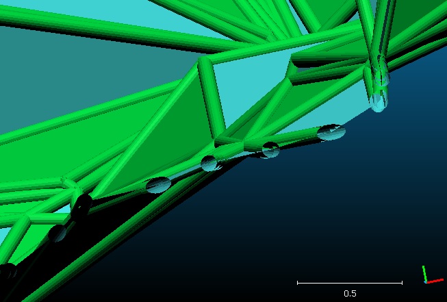

Image 1 : Mesh of the tree crown at t0, and point cloud at t1 (black points we can see around the mesh)

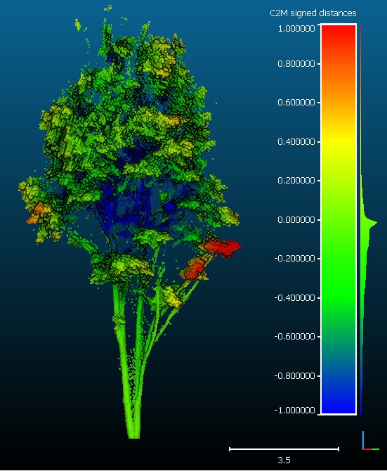

Image 2 : Point cloud at t1. The color gradients is for the distance to the mesh computed with C2M, from blue (negative) to red (positive).
You are probably right, it should be a problem with the orientation of the triangles as some triangles are green and others are blue (Image 1). I don't know how to solve this problem. So, as you can see on the image 2 the sign of the distance are not right (not what I expected), points in the middle of the crown should be blue and those at the periphery red (or the contrary)

Image 4 : Point cloud at t1. The color gradients is for the distance to the mesh (poison surface) computed with C2M, from blue (negative) to red (positive). Here the color made sense, negative points (the most blue) are the points external to the mesh, and positive points (the most red) are inside the mesh.

Re: Signed Cloud to mesh distance
Indeed, this mesh is really strange. Some faces are inverted (the blue ones) and you also have those tubular structures that border the main faces:
Luckily the triangles and segments are separated (see the 'triangles17' and 'segments18' sub-meshes). At least we can isolate them.

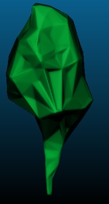

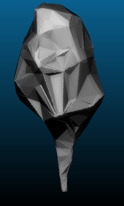

I found a way to export only the triangles of my meshes. But, the problem with the triangles orientation still persist. So I kept your method of i) sampled points on faces ii) re-orientation of the normals (spanning tree) and iii) made another mesh with PoisonSurface. However, on certain meshes (quite "accurate" or "rough" meshes) the normals are not well oriented on all faces and the resulting mesh do not correspond to the initial one. I tried to play with the parameter of normal orientation (neighbors) but it doesn't really change the results. See pictures for an example.
My mesh:
The poison mesh after reorientation of the normals on the sampled point :
Any idea to obtain a better mesh ?
