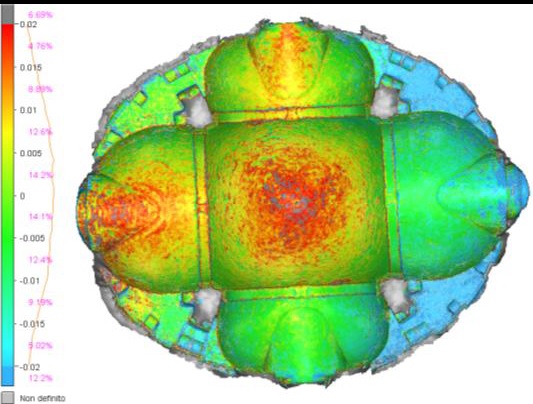

Now i want to do an analysis of CLOUD A, and CLOUD B, i'm interested to see the distribution of point distance in each cloud so how the density change in every part of the church.
you can see an example of what i'm trying to do in the attachment.

If you look to the image in my first post, it shows a map of the distance between the points in the cloud and on the left we can see the % of points in that distance range (i.e. 14.2% of the points are between 0 and 0.005)
I want to do the same thing with two different clouds.

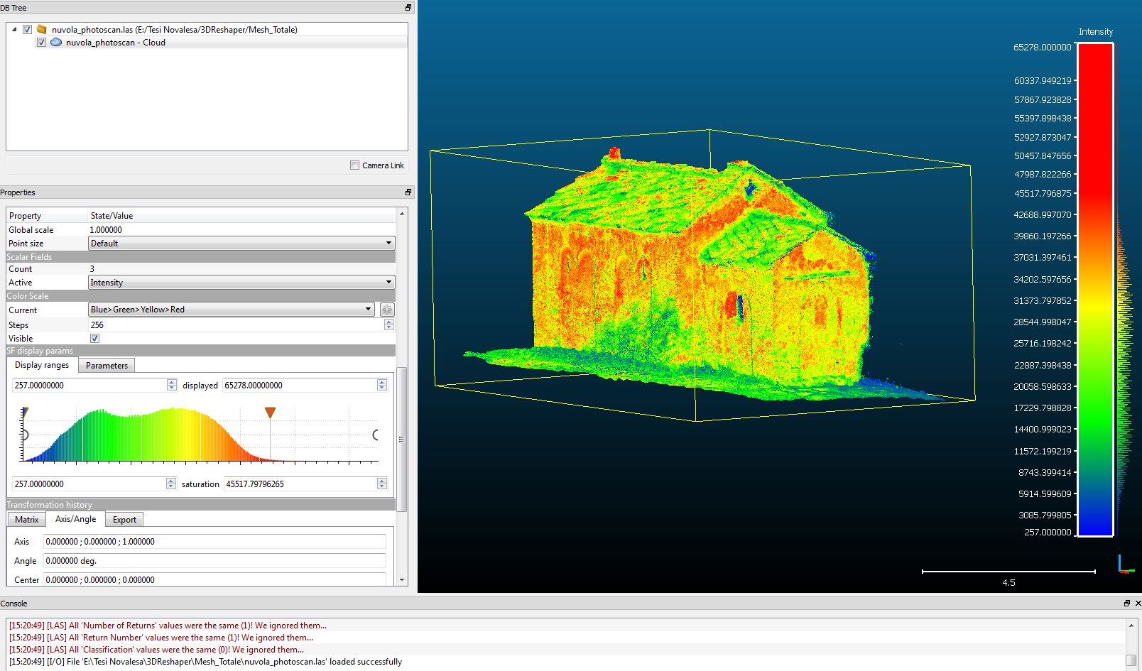

OK i'm trying to do this, but in the scalar fields panel i can choose only between: none, intensity,point source ID, scan direction.
Even in histogram i see a graph of the intensity and not of the distance
i give you a screenshoot
Sorry again for the obvious questions

the point is, that i don't want to show the distance between the two clouds.
what i want to show, like in the image that i've posted in the first post, it's the distance of each point of the cloud from the neighbours points.
for example, if i've 10% of the points that have a distance from the neighbours of 1 cm
i've 40% of the points that have a distance from the neighbours of 0,2 cm
and so on...
and so on...

The 'Histogram view' (Edit > SF > Show histogram) gives a better vision of the histogram (population per class, etc.).
Moreover if one click anywhere on the histogram, a line appears where the mouse is clicked with the current class value as well as the percentage of points below.
