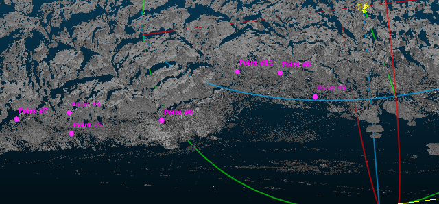

Thank you for your message. I have attached a screen shot image of the point cloud I am using. You will see there are some pink coloured points - these are the points I have manually added on top of the point cloud. I did this by clicking on "point picking", and then clicking on a point on the cloud.

Ok I understand. When you pick a point the info appears on the screen thanks to what we call a 'label'. You can attach labels to any point of a cloud but it's always a manual process.
Therefore you could load you additional points from a separate file, but then you would have to pick each point separately (you can use the SHIFT + left click shortcut to do this faster without using the 'Point picking' tool). Another possibility would be to change the size and color of the additional cloud.
And to export the points you pick yourself, you can use the 'Point list picking' tool to create a new point cloud from your selection (see http://www.cloudcompare.org/doc/wiki/in ... st_picking). Then you can export this cloud as a SHP file.
However it will probably only work with the most recent versions of CC(2.6.2 or 2.6.3.beta). There will be an update for Mac OS next month (but I'm not sure if Mac OS 10.6.8 will be supported). You'd better get a hand on a Windows machine ;)
