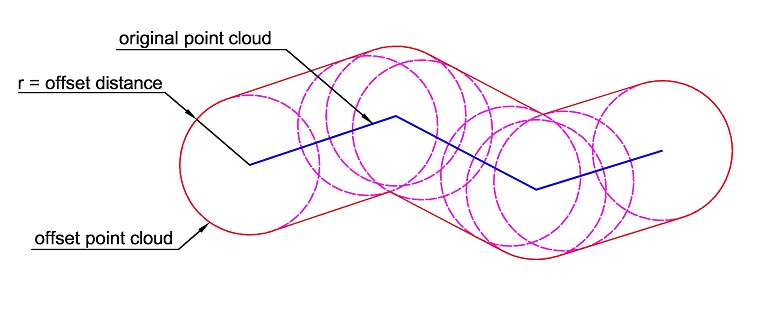

I want to know if you can add an offset tool for point clouds.
in other words, for each point of the original cloud, you have to create a sphere and then add up all the spheres and find a cloud that encloses everything
Alberto
Alberto

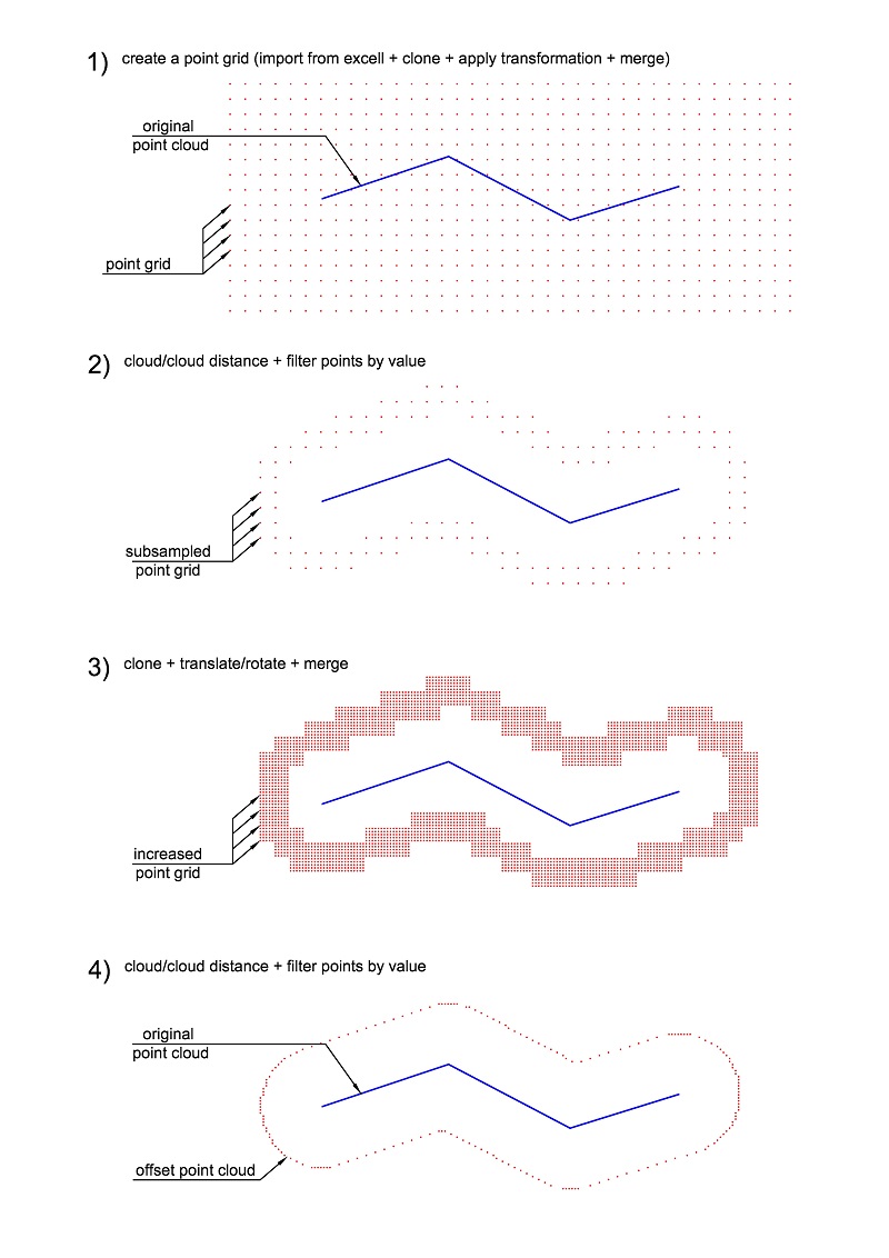

This is my current solution, is slow and inaccurate, I hope you can improve it.
regards
Alberto
regards
Alberto

another possible approach is to place a sphere with a radius equal to the offsett distance on each point, every 3 adjacent points there are 2 points at the intersection of the spheres, after eliminating the points nearest the offset distance, the remaining points represent (with a certain approximation) an offset of the original cloud. To function properly the offset distance must be much greater than the distance between sets of adjacent points.
in addition to the offset radius may be necessary to add to the input values the maximum search distance of point triplets.
regards
Alberto
regards
Alberto
