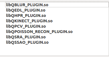

I have a dense (few million points) point cloud, and i have it stored in .xyz normal x normal y normal z format. I wish to convert this to .pcd file. I read that I can use the PCL plugin cloudcompare for the mentioned operation. However in my Cloud compare I dont have pcl plugin. I have attached a screenshot of that. I could not find the plugin as well. Kindly if some one can help? I need the .pcd files for my research purpose.
plugins that are present

What version are you using?
On Windows you may have to use the 2.6.2 version (as the beta version is not always compiled with PCL).

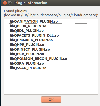

I have installed 2.6.3 now, but I still dont have the PCL plugin. I have more plugins but not the one I want .
Posts: 8203
Re: XYZ to PCD
Hum, I must have missed something with the latest Linux integration... Then you'll have to compile CC yourself with PCL support (or use the Windows version ;).
