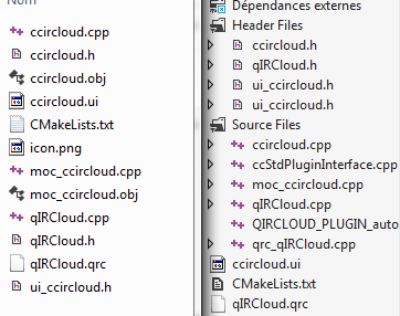

its strange that two "ui_mainwindow.h" are created.
I tried also to import my Qt files without Cmake
(" mainwindow.h"; "mainwindow.cpp"; "ui_mainwindow.h"; "mainwindow.ui" and "moc_mainwindow.cpp"),
and this time, it worked.
I don't understand why since I had the same files

I changed the name but had the same problem
Here are files in my plugin.

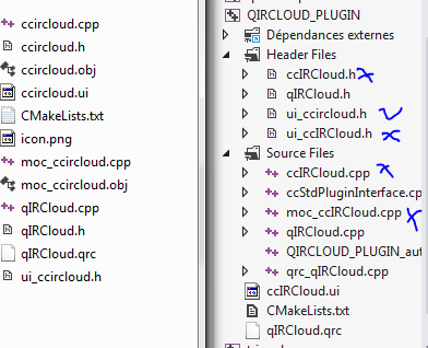

I found it. I shouldn't have put the moc_.. and ui_.. files in my plugin.
