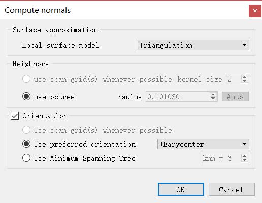

When I use tools to computer cylinder cloud normal, the result shows successful.I set parameter like this which is show in picture.
.Unfortunately, when I compile from source file,the result of the normal compute show not successful.I have tried 2.8.0、2.8.1 and 2.9.0 version source file, could you please tell me the reason?

Have you compiled with CGAL? Triangulation requires the Delaunay algorithm which is provided by CGAL.
