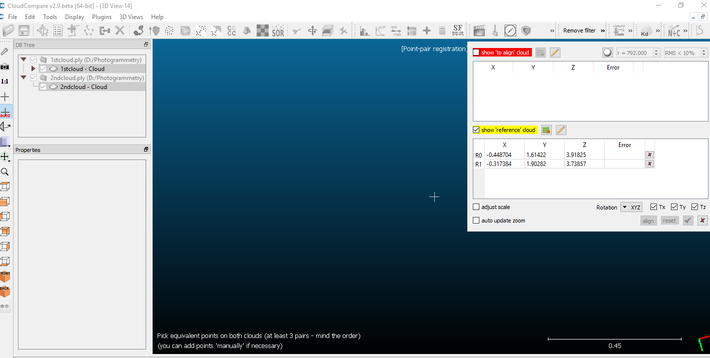

I have CC 2.9 beta 64bit
Seems when I select two images for alignment and start selecting points... when I zoom or rotate, the two clouds disappear. I have to close point selection then the clouds re appear. I have not aligned any clouds yet because of this. Should I roll back a version?
Running i7 with Gforce 1060 16gb ram

Sorry, it seems I missed your message.
Actually, does the problem disappear when you roll-back to the 2.8 version? I don't see why it would, but this would be very informative.

Notified Daniel as we are having the same problem.
I'm running V2.8 64bit. Our issue is when selecting spheres the cloud disappears.
Weirdly when you just select points, its fine.

Re: Bug aligning clouds
For the records, this issue has been fixed in the latest beta release.
