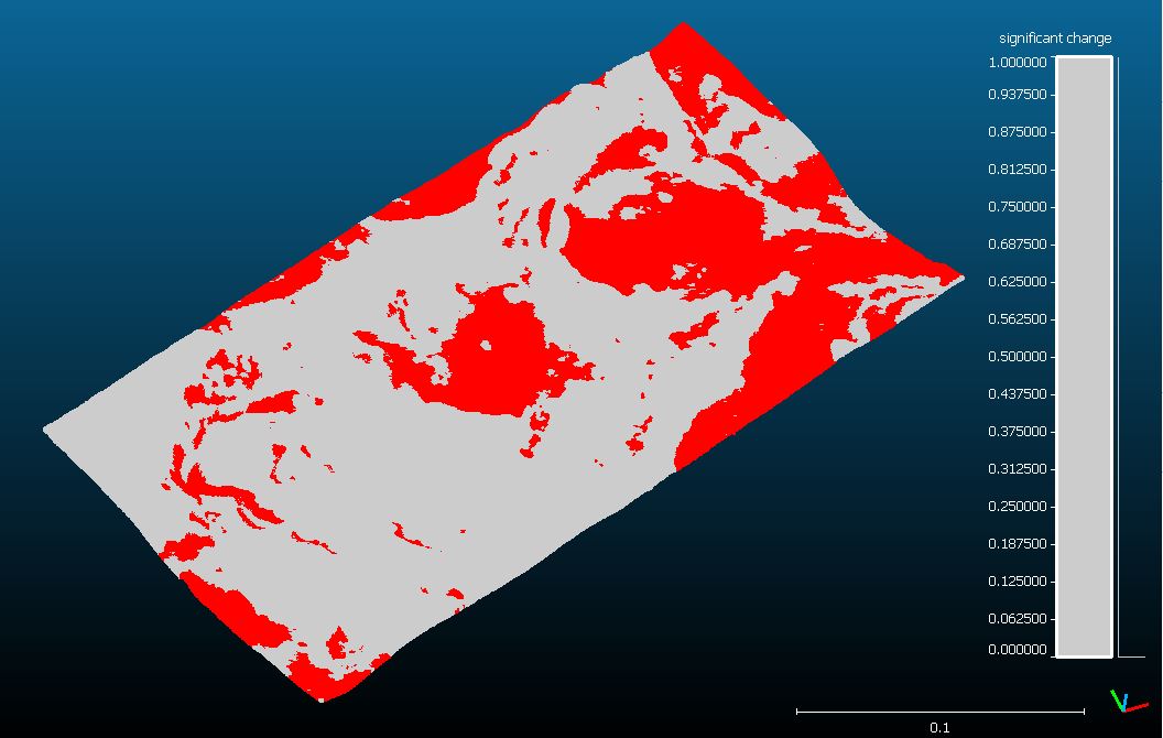

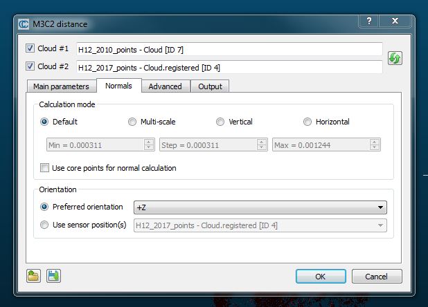

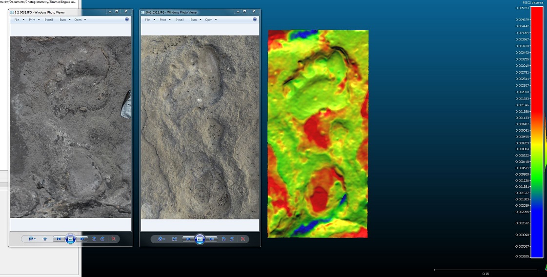

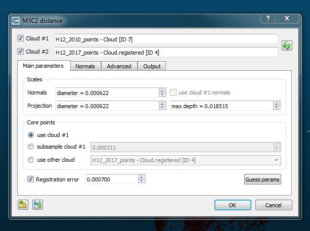

2) I also have used the M3C2 algorithm to estimate change, but all my points come back red (insignificant change). In the attached image, you can see the change is real, but something in my parameters is not scaled correctly perhaps. Parameter and normal settings attached as well.

2) Isn't the registration error already quite high? (relatively to the scales, etc.). Can you try without it?

I ran a couple of M3C2 tests and the data are all colored red for insignificant change even when I do not check "Registration error" or if I use .0000001. Perhaps the texture of the footprint itself is being interpreted as surface roughness?

I just realized: '1' for the 'significant change' scalar field means that all points are considered as being a 'significant change' actually ;D.

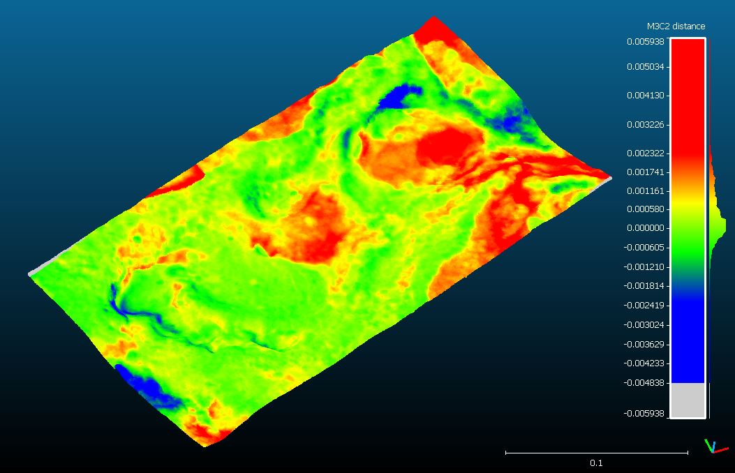

I did a quick and dirty registration (ICP with 30% of overlap - I didn't know if you had already registered the clouds). It gave me a 0.00045 RMS. And then I used the 'auto guess params' button in M3C2 (still quick & dirty) with vertical normals.
And the result seems quite consistant: For the records, the projection diameter was 0.000708, the normals one was 0.001416 and the depth was 0.020349.

This is great news. Thanks for taking the time to run the clouds and for the clarification. I think my primary confusion came from the fact that under the "significant change" tab, all pixels were either colored red or grayed out. In Lauge's paper and on the wiki page, red is identified as non-significant change and gray means no matched points. I am thrilled to see that this analysis will work.
