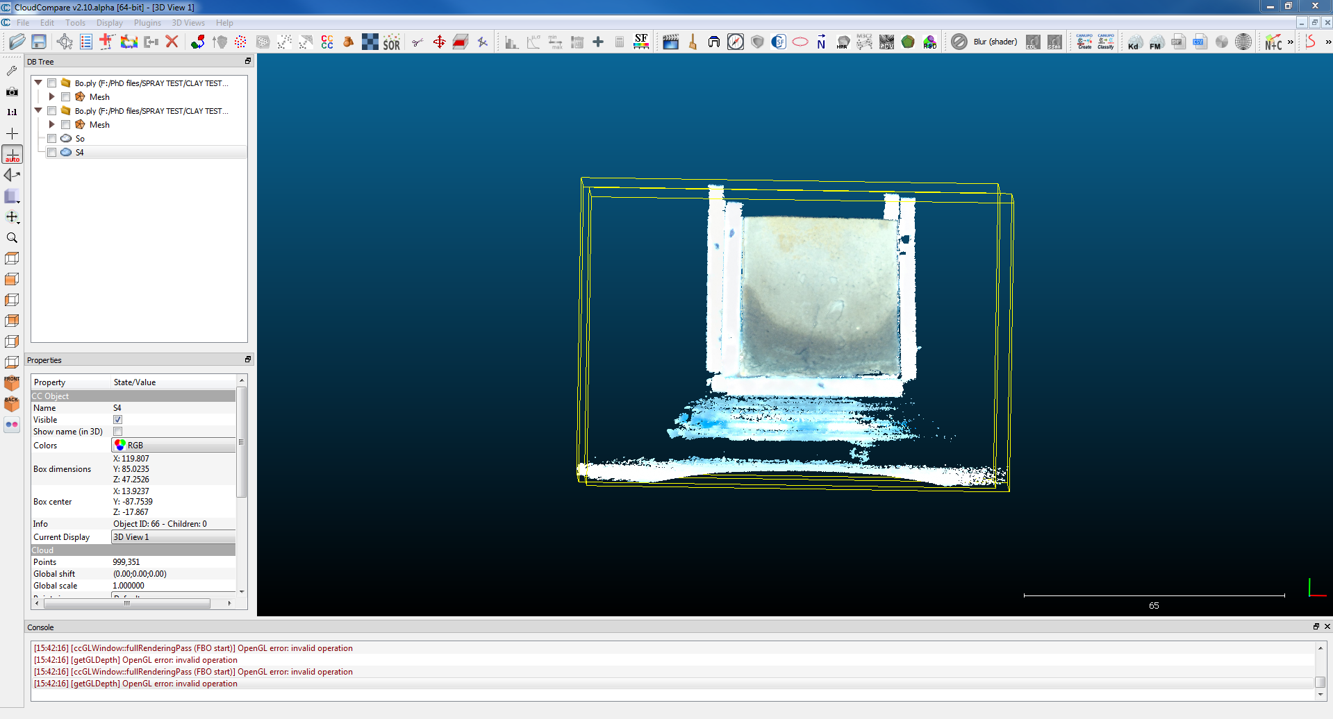

Hi, my system freezes when I tried to pick points in order to register my cloud data. I am currently using v2.10.alpha. I had the previous version but was experiencing same problem.
- Screenshot of issue.PNG (378.09 KiB) Viewed 1550 times
- Error message shown.PNG (7.05 KiB) Viewed 1550 times

What is your graphic card?
And when CC asked whether it could compute an octree for point picking, what was your answer? (if you have doubts, your can reset this behavior by changing the "Auto-compute octree for picking" mode in the 'Display > Display options' dialog.
Apparently you have a graphic card issue, therefore I would advise you to always use the octree (which shouldn't depend on the graphic card for picking points).
