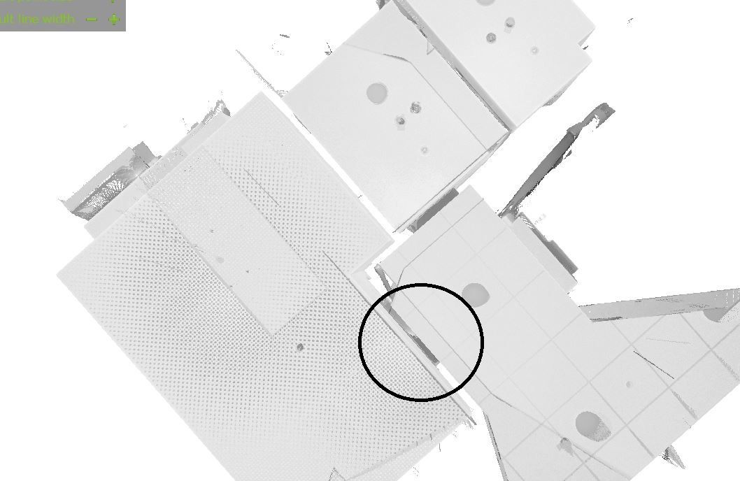

Image 1 shows the project point cloud and the position of the scan. (my scanner positions is in a room, so it is only 25% points from this position)

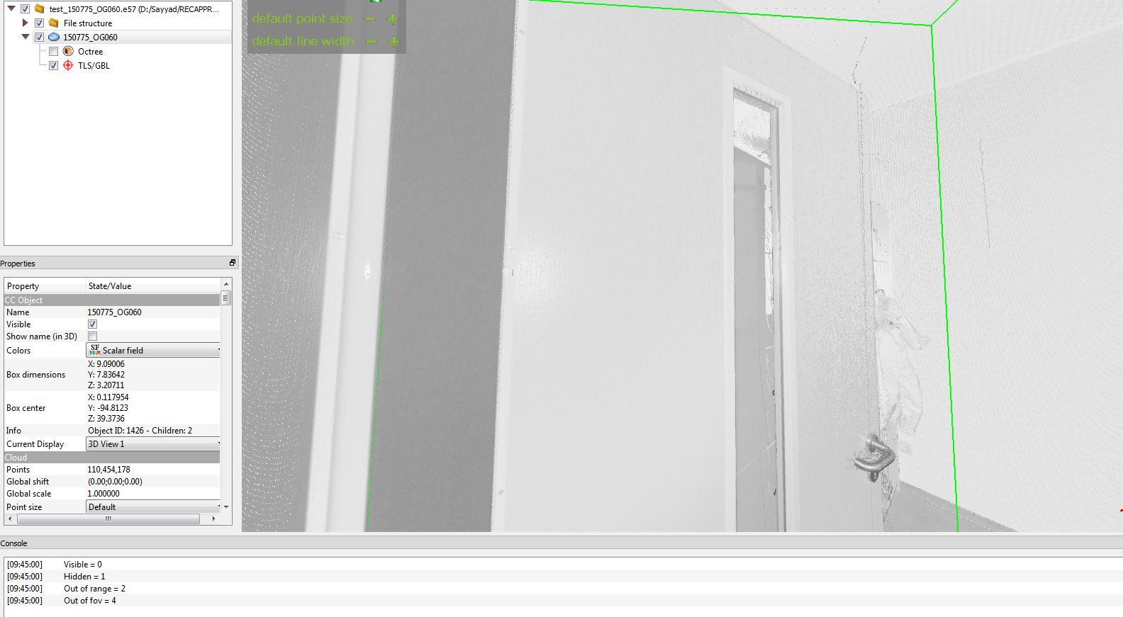

Image 2 shows created scan position with bubble view.
I created depth buffer.

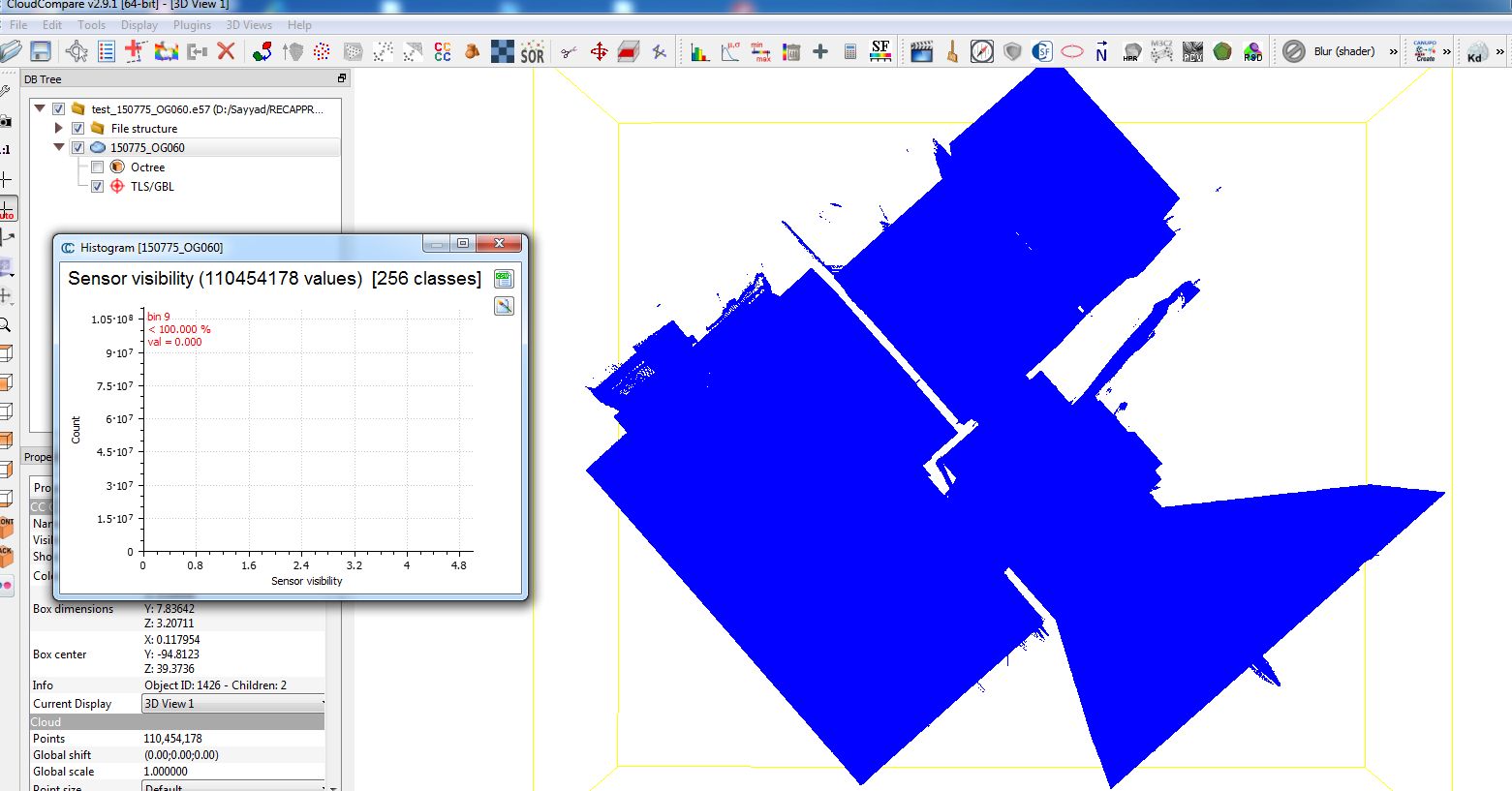

then I created point visibilty map. But as you see in image 3,I can't segment point based on visibilty, because all points have scalar field= "0".
What I am doing wrong.

Indeed, I'll need all the data (cloud and sensor information).
