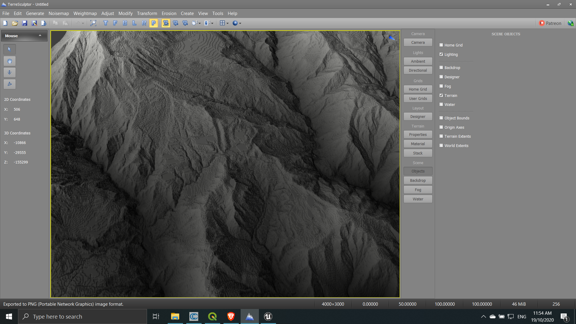

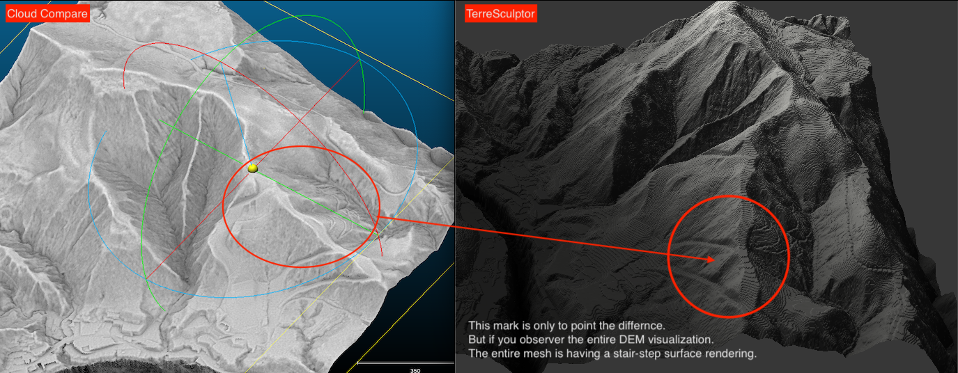

Surely the RAW tiff is more than 8bit, but my goal is to create a Rasterized "Image" GeoTIFF.
Im exporting from Tools/Projection. When I import the rasterized image GeoTIFF to TerreScultor for DEM Visualization, the points are not extrapolated and the mesh looks jaggy (step-stairs look). It does not render in the same quality inside like the way CC render the points via pcv and edl.
Maybe there is something wrong with my export process. :,<

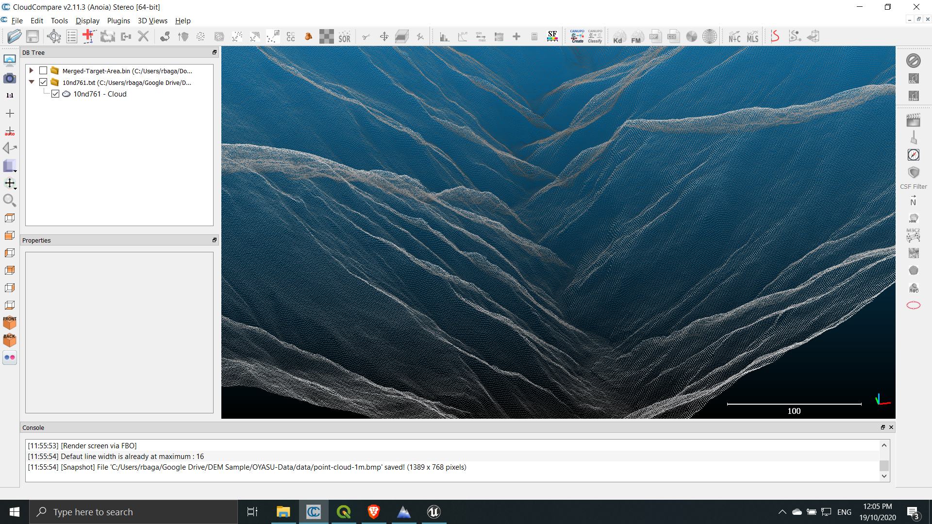

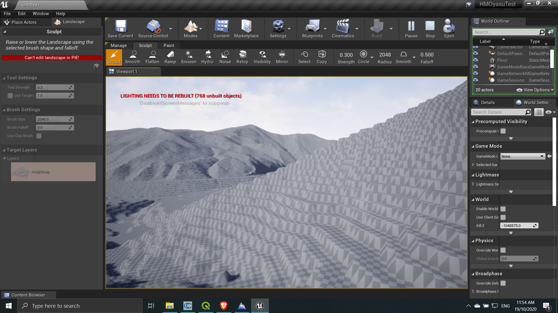

Re: Exporting a 16bit heightmap?
Hello sir,
So I kinda got additional information however, I still have not resolved the terracing effect.
Cloud Compare exports a Float64 RAW TIF.
TerreSculptor is using Windows API library for management of image file types (BMP, GIF, JPG, JRX, PNG, TIF) called the Windows Imaging Component or WIC. WIC unfortunately does not support 64-bit floating point grayscale images. 32-bit grayscale is the highest that it supports.
TerreSculptor will only support 8/16/32 bit grayscale and 8/16/32 bits-per-channel RGBA color (32/64/128-bit color).
That said, running a GDAL convertion is the other option which is also supported by QGIS.
That means the rasterised point cloud data can be ported to TerreScultor albeit an conversion processing is required either via gdal command line or QGIS.
NOW, we are able to troubleshoot data importation, that means that the terracing effect in the 3d mesh is probably not an issue with data interpretation. It seems like the interpolation is was correct when creating the raster image.
Is there some sort of TIN interpolation or data extrapolation in Cloud Compare?
We took a 1m lidar resolution for a mountain, inside Cloud Compare, the visualization seems accurate but the rastered image doesnt seem to interpolate between points hence the terracing effect. Here's the screenshot from Cloud Compare to TerreScultor to Unreal Engine
