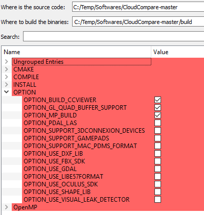

I am trying to build CloudCompare from the source code. I have done this many times before and even this time, it is successful but I see no option to include libLAS this time. Surprisingly, I don't see the option in CMake which allows to include libLAS along with CC, i.e., the OPTION_USE_LIBLAS is missing. Can anyone suggest me a solution for the same?

Liblas has been replaced by PDAL which is well supported (contrarily to libLAS which is a bit deprecated).

Okay, I'll install PDAL then. Thanks for the prompt response.
