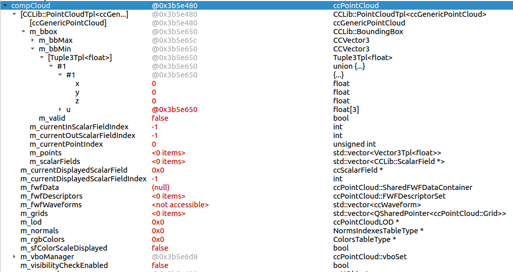

My main problem is that, when I compute the distances, I get a mean distance and deviaton of zero. I also have to resize the clouds in order to avoid errors. It's like the ccPointCloud doesn't have any points even though the reading function returns CC_FERR_NO_ERROR and the cloud it's correctly displayed.

When I debug I get that, after the casting, the cloud is apparently empty even though is displayed in the viewer without problem.
Does anyone know what I'm doing wrong? Any kind of help will be useful.

comp_example is a ccHObject instance (a 'group' object). You cannot convert it to a point cloud directly.
You have to look for its children (normally there should only be one if you load an ASCII file) and this child should be a point cloud. Pay attention that ccHObjectCaster::ToPointCloud may return a null pointer (if the input entity cannot be converted to a point cloud).
Re: Problem with empty ccPointCloud
And if the cloud is empty, it's for a reason. No need to 'resize' it to make the function 'work'. As there will be no valid point in such a cloud.

Thanks! I was sure that i have tested with getting childs from the ccHObject but there must have been other mistakes when I tried. Now I'm dealing with some errors in the cloud2cloud distance calculation but, at least, my clouds have some points!
daniel wrote: Wed Mar 13, 2019 8:13 pm And if the cloud is empty, it's for a reason. No need to 'resize' it to make the function 'work'. As there will be no valid point in such a cloud.
Yeah, I know it doesn't have much sense but after a couple of hours trying to solve it I started to think that there was a kind of bug. It was more like something I did to debug. Sorry for including it in the posted code.
