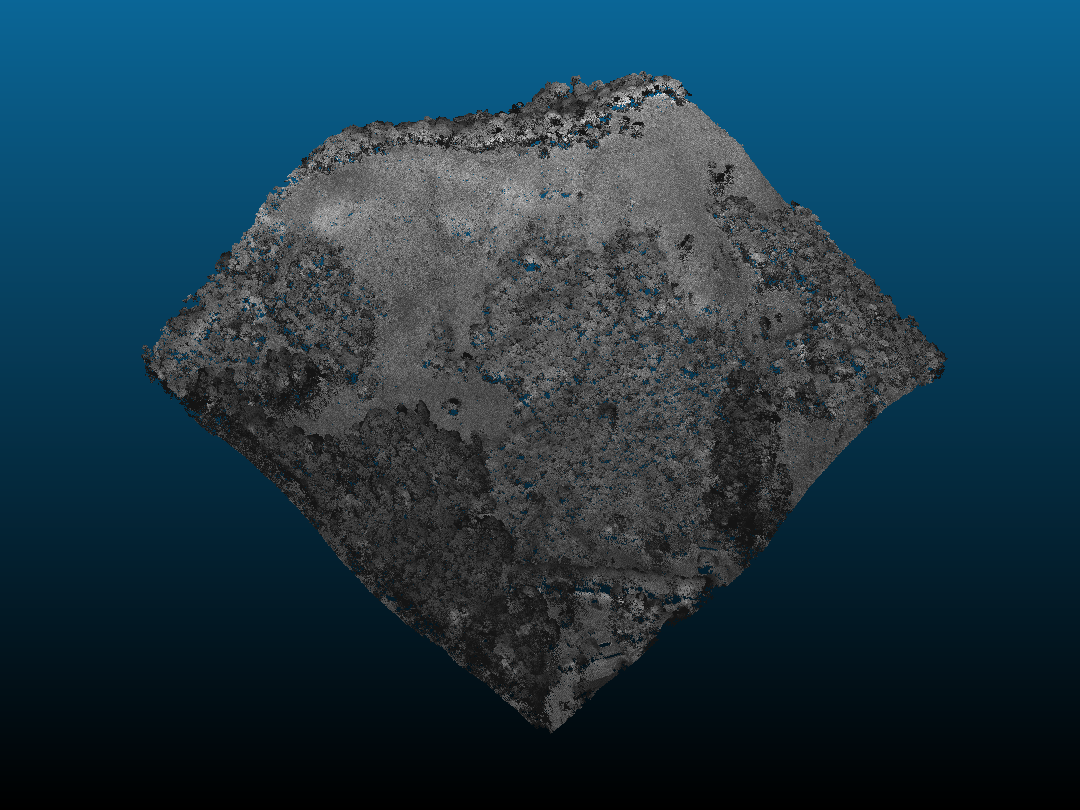

I'm using CC to process some ALS data. I've started going step by step and now I'm advancing on...
My data:
ALS with point spacing of around 0,25m and density of 20-25 points / sq m on a high steep terrain partially covered with high vegetation.

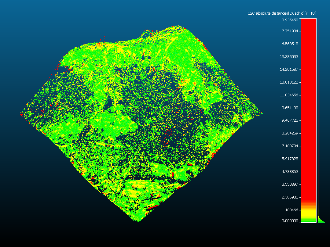

-- C2C by local model (quadric, radius of 10): returned the distances, but no signed distances. Got a glimpse of the distances and this might be a good orietation for the other ways of calculation distances. 18.93m was the greates distance.

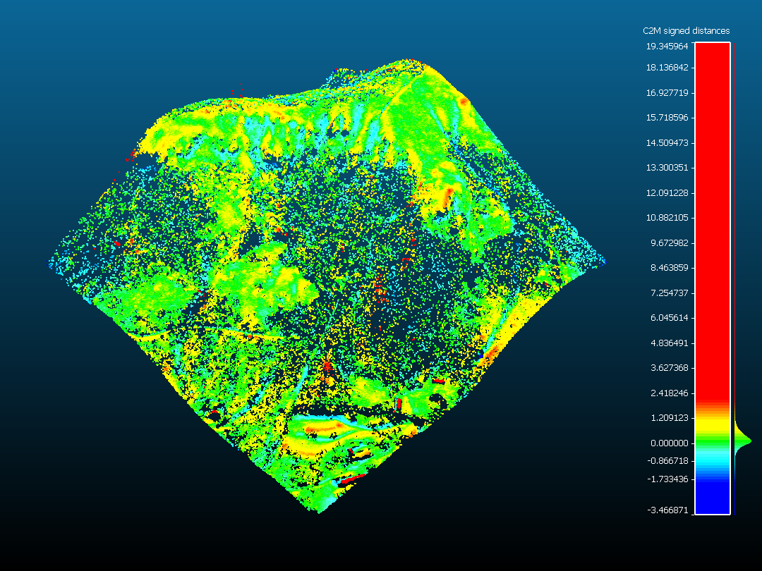

-- C2M got the signed distances and great visualization. This I can understand better as the points get lower from the surface or above it. I managed to create a color legend that shows in green the variation of 0.5m around the surface (0m) and gets another color by 1.0m and extreme colors by 2.0m I'm interested in the most points around +/- 0.5m of the reference (cloud or surface). 19.34 was the greatest positive (above ground) distance calculated. An increase of 2.17% for the same cloud. <br/>

ALS data
ALS data

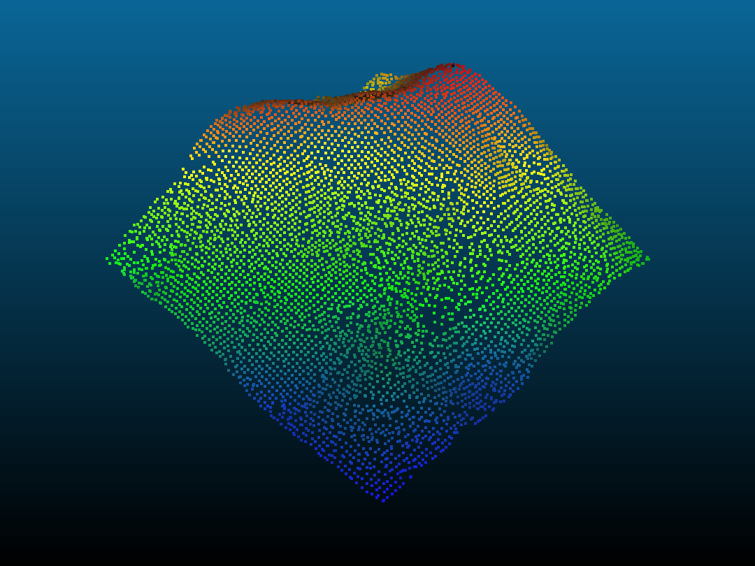

Reference cloud obtained by rasterize tool
C2C distances
C2C distances
C2M distances
C2M distances

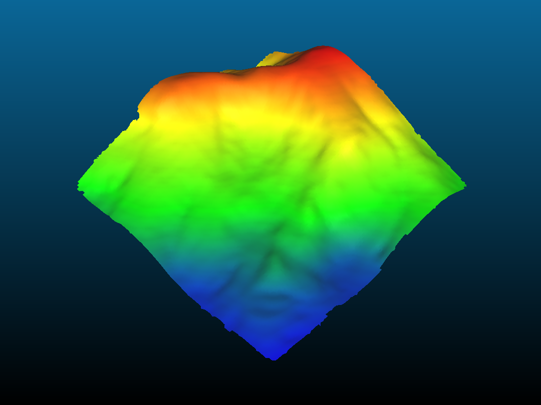

Reference surface by PoissonRecon
