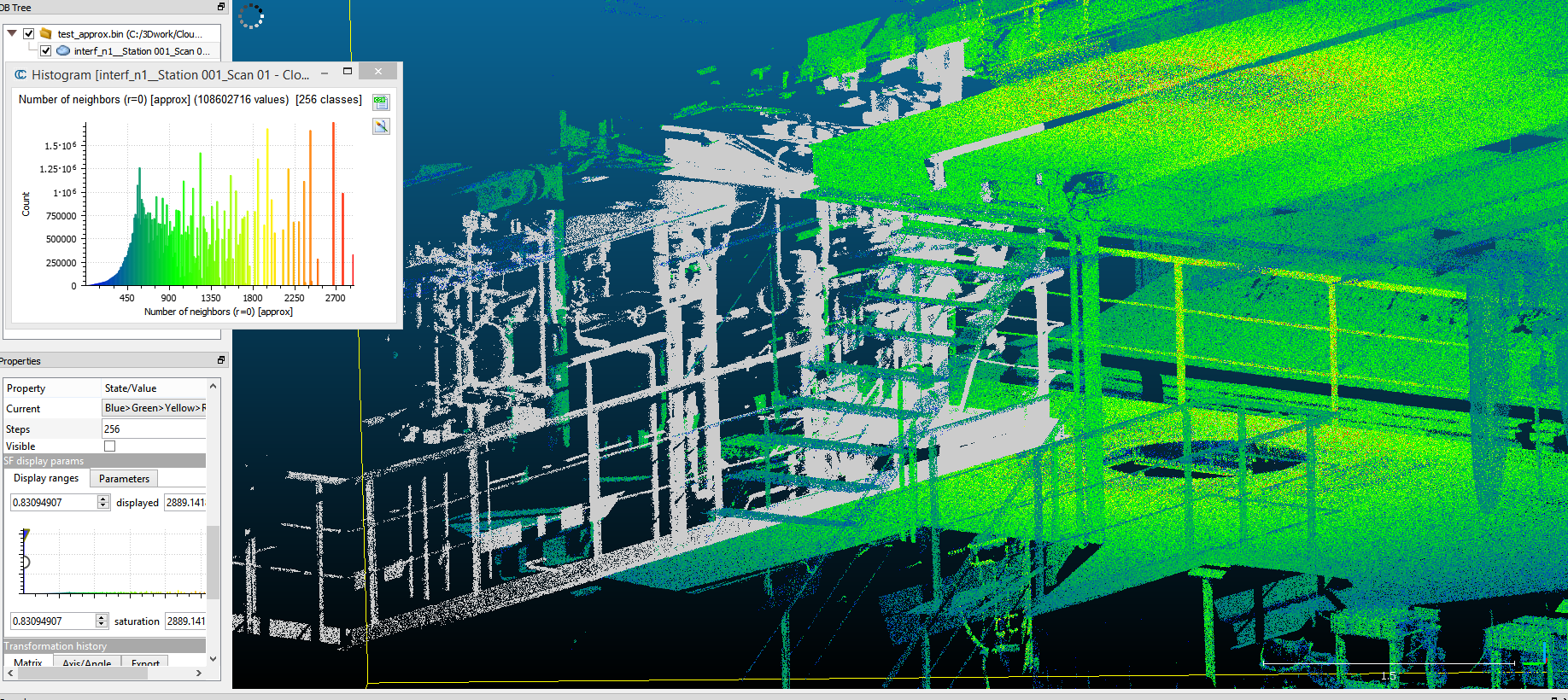

But a new wild question appears!
That's troubling because after using the approx density I've got a whole part of my cloud under NaN values, see PNG in attachments.
Is this normal ?
BR
Posts: 8203
Re: Method to compute spacing between points
How strange...
I just realized that the "Approx density" tool was not accessible in the latest 2.11.alpha version... it will be hard to debug.
The only reason I would see is that some points are duplicated. Then the distance to the closest neighbor is zero, and the density is infinite (= NaN).
Can you try to use the tool 'Tools > others > remove duplicate points' first and see if some points are removed? And then compute the (approx) density again?
thierry
Posts: 15
Joined: Tue Sep 17, 2019 7:20 am
Post by thierry »
It works ! Thanks a lot.
