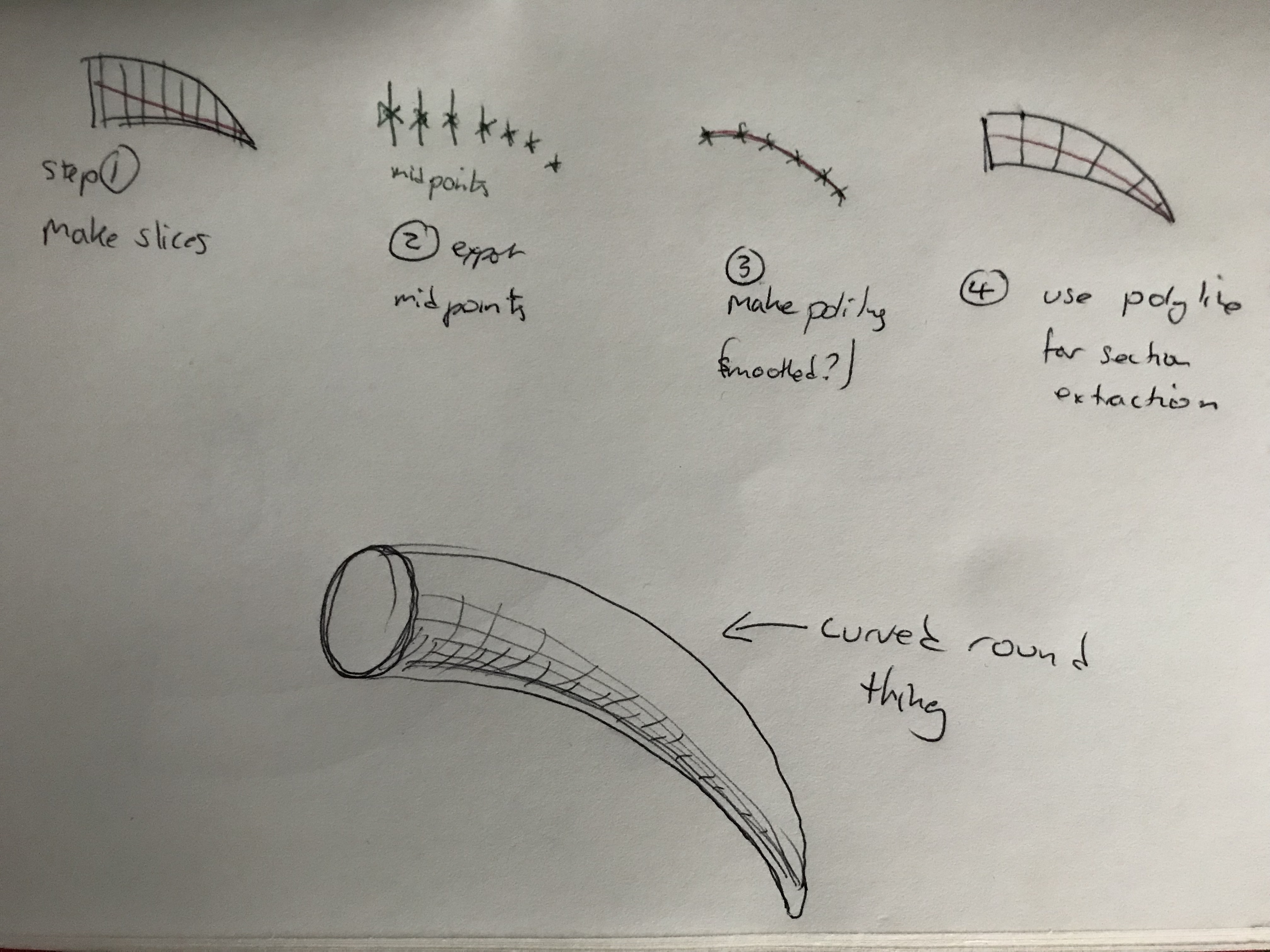

Re: auto-trace polyline from linear point cloud
Thanks, see if this makes anymore sense.
- IMG_0675.jpg (1.72 MiB) Viewed 22528 times
Wow, thanks for the drawing (much clearer).
And sadly, that looks much more complicated ಠ_ಥ
Sorry, I really don't see how to do this (well appart if you want to write a hell lot of code ;)

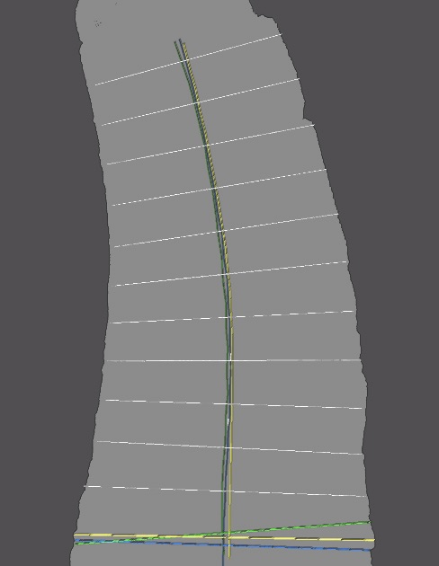

If it's useful to anyone else some of it can be done with blender. It won't suit everyone's needs and it depends greatly the shape of the object and the density of the cloud for example but loosely you do this.
Use the section tool for a rough line along your object and extract slices
tools->batch export->object info
open this csv back into CC
save as ply (can't figure out opening csv in blender at the mo)
open ply in blender
go into edit mode, and extrude all points slightly to one side
save the selected vertices as vertex group
select all
bridge edge loops
select the vertex group and delete leaving only original vertices now joined up
perform smoothing and point filling operations as you require. (top tip, deselect the first and last vertices when smoothing or the line will contract)
export as obj or dxf (make sure your axis are consistent (y forward z up etc)
open in CC - you now have a line following the estimated midpoints with sections that angle smoothly along the shape.
It's not flawless or fully automatic, The mid point estimates will be different depending on your starting rough line, how many slices you make etc, but looks like it should be with in tolerance for my needs, but testing that will come later.
If anyone has something more elegant, or mathematical please say!
Oh, and i'm also having trouble getting the line back in as a polyline, rather than a lot of segments. It's not detrimental to my needs, but for larger more complex objects it would be nicer to have one line.
