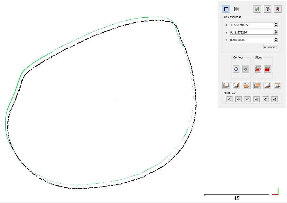

In a more limited way, you can use the Cross Section tool (or 'Clipping box') with the two (or more) entities selected. Then clip the points you want to compare - typically with a thin slice - and eventually hide the box interactors so as to only see the points (you can even set the view parallel to the cut).

And one more problem:
After making the sections on two clouds along the same (about horizintal) line I tried to transform one of the sections to make better registration. Of course I made it at "top view". The translation worked, but I couldn't rotate the section around the "Z" axes, just around another which tilted the section out of the section plane.
And after this, switching off the translate tool ang giong back to normal view, I couldn't rotate any clouds around all three axes by mouse, just around one axes vertical to the screen. Even if I swiched off all the sections and everything.
I may use wrong technique to register better the clouds by sections?
Posts: 8183
Re: Cross Section - Line & Graph tool
I'm confused. Which are you using here? The Cross Section tool? (then you have to use the colored torii if you want to rotate the clouds, and you have to move the mouse horizontally or vertically depending on the axis).
But in general I wouldn't advise using any manual registration. You can extract some slices if that's what you want to use as reference, and then apply a proper registration tool (Point-pair alignment or ICP). And eventually use the resulting transformation matrix (output in the Console) on the original cloud for instance.
