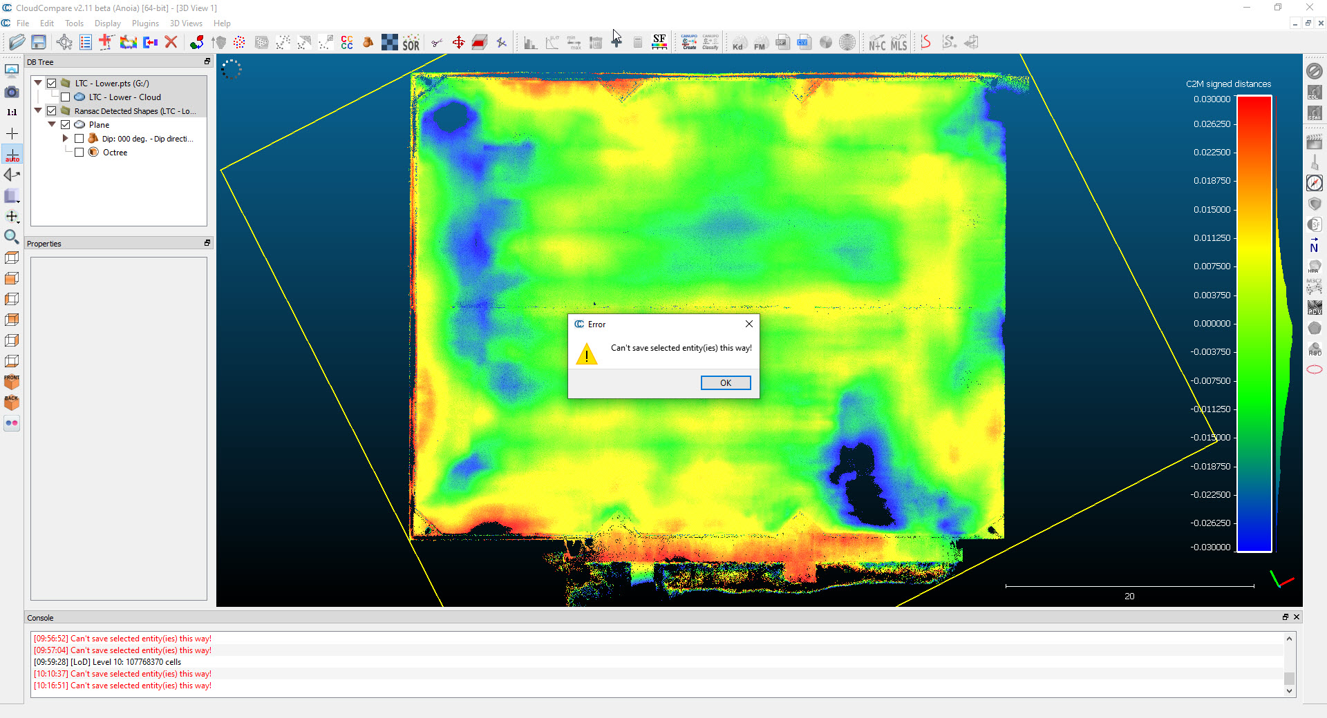

While trying to save my work. I get a "Can't save entities this way!" error. What am I doing wrong?
CC Saving Error.jpg (568.69 KiB) Viewed 22033 times
Re: Saving Error
Warning, your selection is weird. You have selected two 'groups' (and a cloud inside one of the groups). What happens if you select only one cloud or one group?

Re: Saving Error
Post by Shaver702 »
Same error. :/

Re: Saving Error
Post by Shaver702 »
I just opened just to point cloud and tried to save it and i got the same error.
Re: Saving Error
Can you send me the cloud maybe? (admin [at] cloudcompare.org)
Is it the latest beta release?

What file format are you trying to save this as, some don't support more than one object, or hierarchies (the folder structure), or meshes.

The PTS file is 26 Gbs. And my Box account won't allow me to upload it. Too large.

Post by WargodHernandez »
It starts as a PTS, are you saving it as that as well?

Post by Shaver702 »
I just hit the save button and don't get any farther. I don't get the option to select any other format.
Re: Saving Error
And do we agree that you only highlight one cloud for this test? (like 'LTC - lower - Cloud' or 'Plane')
