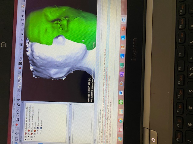

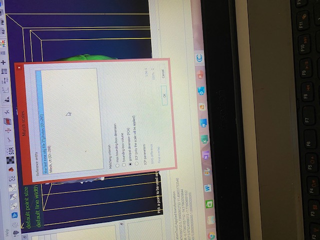

hi all,
when i am trying to Align (point pairs picking), it come with this error as the screen shot show.
i cannot align all the model just CT mesh.
regards
Raghad
regards
Raghad
- IMG_2210 (1).jpg (85.08 KiB) Viewed 12528 times
- IMG_2209 (1).jpg (83.41 KiB) Viewed 12528 times
Re: obj file and import a CT Dicom data
To compare 2 meshes: see https://www.cloudcompare.org/doc/wiki/i ... comparison (and pay attention to the very last section)
Otherwise, which version of CC are you using? (note that it would be better to make screen captures of your screen (with the Snipping tool, or the "Print screen" key, or even the "ALT+Print screen " shortcut ;)
