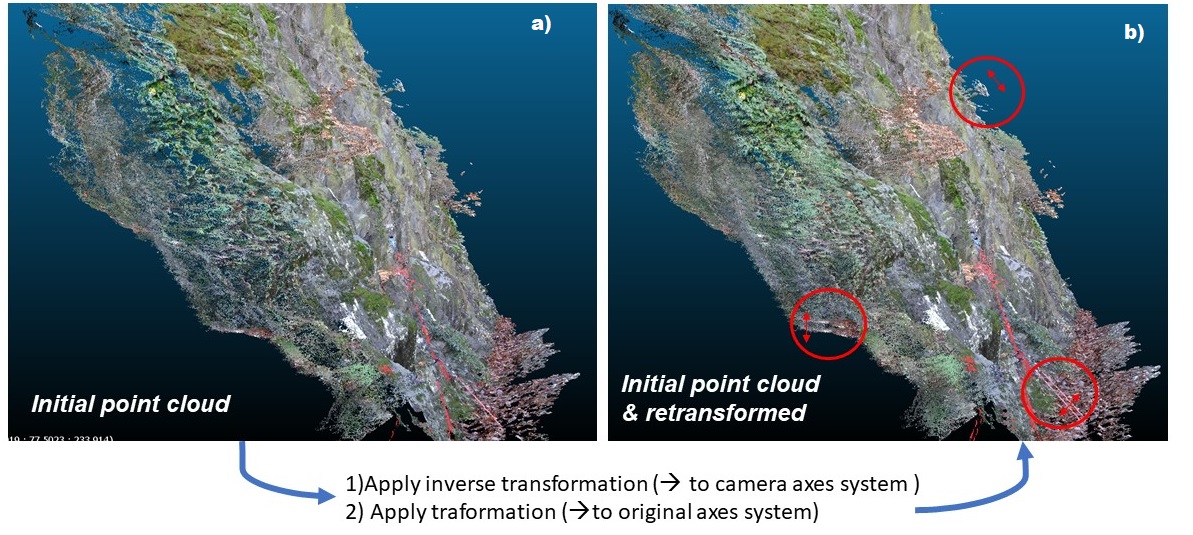

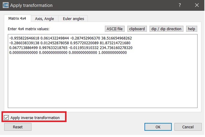

I have a point cloud (axes x,y,z, origin o) that I need to transform according to camera axes orientation (let's say x',y',z', camera center c to be used as origin). To do this I've calculated the 4x4 matrix necessary to apply the rotation and translation of my system, and I've used it in the "apply tansformation tool".
The result seems good, but when I retransform it back to the original axes (unflag the "apply inverse transformation", figure b) the outcome doesn't completely match the original point cloud (figure a,b).
Presentazione standard1.jpg (256.6 KiB) Viewed 17442 times
Why does this happen?
Thank you for your kind help
Cheers
Snaphu C.

2 options:
- the transformation is not perfectly orthogonal, i.e. each vector (= 3 first columns) norm should be equal to 1, and they should all be orthogonal to each other (X.Y = X.Z = Y.Z = 0)
- the coordinates of the cloud are too big (in case you ignored the "Global Shift" warning - if any). And the loss of accuracy explains the issue

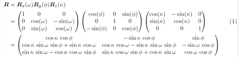

Thanks for reply, I use the camera angles orientation (omega, phi ,kappa) to calculate the rotation matrix using the equations as :
So i think that each vector (= 3 first columns) mathematically is equal to 1, and they should all be orthogonal to each other (X.Y = X.Z = Y.Z = 0). Am i wrong?

So I'm positive that the matrix used was not orthogonal (according to wolfram alpha at least :) )
using the Orthogonalize function on wolfram alpha for your original matrix gives
-0.95582263396 0.061432249030 -0.28745290256 38.516654968262
-0.28723579125 0.012527465527 0.95777798202 81.873214721680
0.062439511834 0.99803263543 0.0056715055617 234.736160278320
0.000000000000 0.000000000000 0.000000000000 1.000000000000
using that matrix instead of the original, the transformation is reversible using the inverse transform. (at least within numerical accuracy of of our transform class) I'm seeing slight z transform differences before and after (-7.6294E-06)
