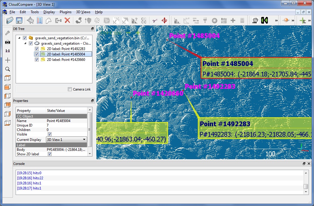

Re: Selecting point, or multipe points
Thanks for links - helpfull.
I do not try to select "points" in point cloud.
I want to select points what are already picked with "Point picking" tool, and has it's own "square" and label in view.
Well, in theory when you select a label it should become highlighted (red border around the label). It works either direclty on screen (on the label itself) or on the corresponding DB tree entry.
Are you doing this while your plugin is running? Maybe you have a modal dialog opened preventing you from interacting with the main interface?
something here is wrong (i enabled "Show 2D label" as in your image)
i have view like below:
if i select anything on tree (shown on left screen side) it works - and border (red) is shown
but if i try click anyware on "3d view" (right side) - i could NOT select any point or label assigned to it.
Selecting 2d label works - if no mesh or points is behind it. (point 1 in upper image)
(2d label are so large - why should they be used?)
I want to "select" red square that is painted on "picked point" (not label)
Perfect solution would be selecting multipe points - with drawing rectangle with mouse (area)
if i move labels outside mesh/cloud point like in image below:
sellection works.
but again "2d labels" are too big for use. 3d labels or those little squares would be great.
is some kind of "mouse grabbing" implemented on CC?
sellection works.
I've modified the default point marker. It's now a sphere that the user can select in the 3D view. It goes from magenta to red if selected. So in your case you should hide the 2D part of the label and only work with the 3D version.
