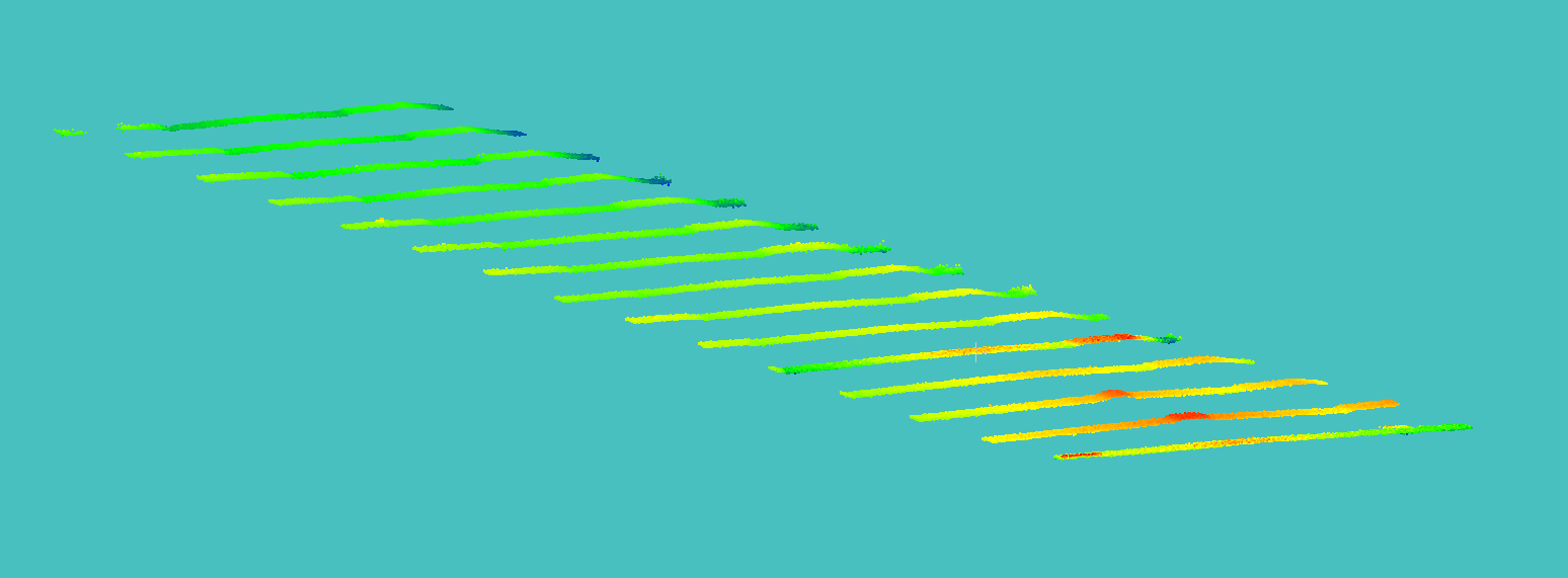

Dear CC-users,
i am searching for an elegant way of a "local pointcloud analysis".
I attached some example screenshots and looking forward to read your suggestions.
The scan is from an airborne lidar and i'd like to assess the quality of the scan on a road surface.
A paved road should be a sharp / crisp surface in the scan data.
The more noise and thickness the data shows the less useful it is.
What in your eyes could be a good approach to easily see areas of higher thickness, its thickness values and so on...?

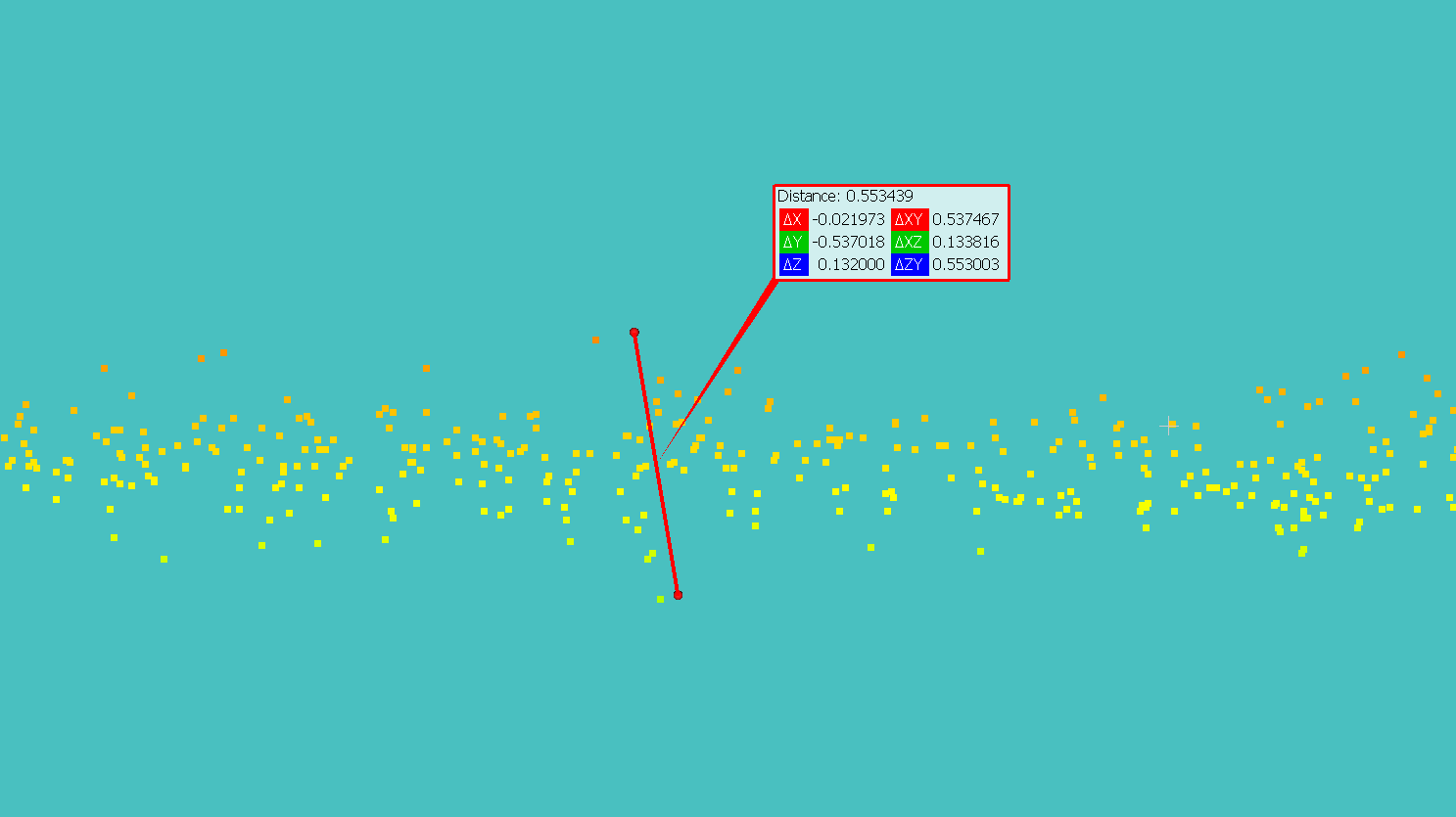

thickness (dZ) visible, but not local (watch dY)

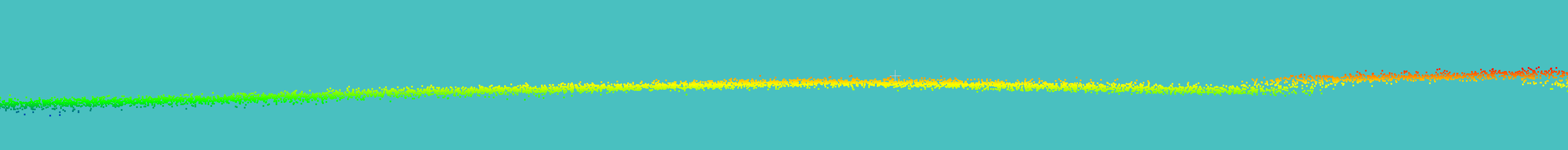

side view of single segment_far

road segments to analyse

You could try to compute the local "roughness" (https://www.cloudcompare.org/doc/wiki/i ... c_features)
Or use the Rasterize tool, and export the grid as a cloud with 'height std. dev.' and 'height range' in each cell:
