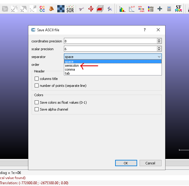

Now I have to use file manager to manually rename (points.txt) to (points.csv) so QGIS can accept it for layer import
Also, it will be helpful to set default separator to comma instead of space in ASCII saving box (or let CC remembers last choice"

I prefer CSV and comma as separator because it is easily export to other software QGIS LibrieCALC etc
bu I understand
(and CSV is clearly not the default use case for the majority of users ;).
I did some research about if CC can remember parameters in cloud ASCII save dialogue
I compiled 2.12 from GitHub under Ubuntu 21
Result is
1- CC can remember your choice for cloud saving if (ASCII) or dxf etc
in Win and Linux
(in Linux CC save settings in /CCCor/CloudCompare.conf) at least on my PC
(in Win it is not clear how it save settings??)
2- However CC does not remember other parameters (separator "," or space precision etc)
3- In Linux CC saves settings in /CCCor/CloudCompare.conf including parameters (separator "," or space and precision etc) but unfortunately it can not remember (bug??)
4- I changed source file AsciiFilter.cpp to change default ASCII file extension to CSV and to change default separator to "," after I compiled CC changed its parameters to to CSV and ","
my change is
line:48
static int s_outputSeparatorIndex = 2;
line:93
"csv",
I hope in near future somebody let CC remember all parameters
