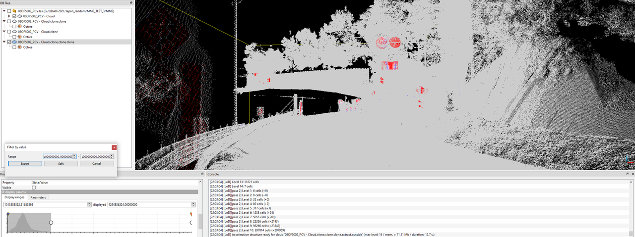

I'm trying to filter an intensity value to a separate cloud in order to reduce its high value but I can´tn splic the cloud bcause of the high value

You could try remapping SF values to a smaller range:
Calc icon or Edit > Scalar Fields > Arithmetic:
SF 1: Intensity
operation: divided by
SF 2: [Constant Value]
put in a large number, ie. 1000 or 100000

How did you generate such big values? As CC store the values on 32 bits, it's generally a very bad idea to use large numbers...

I was searching for an specific post I made and found this unsanswered.
Thank you for hte divide tip, likely that should fix the issue. I can´t recall why intensity values where so crazy. But I keep the tip!. thanks!
