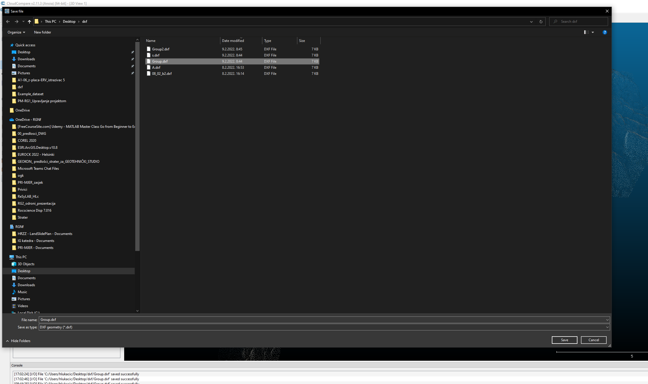

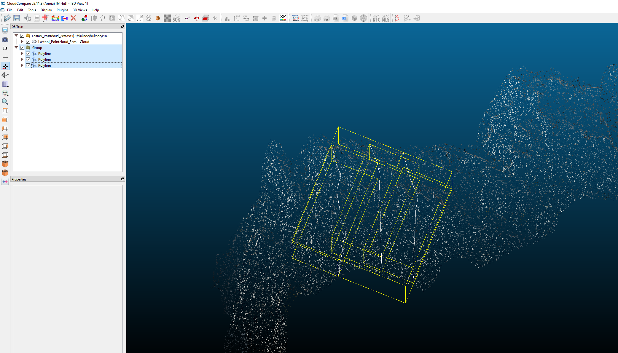

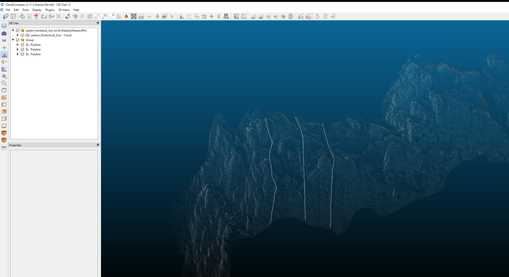

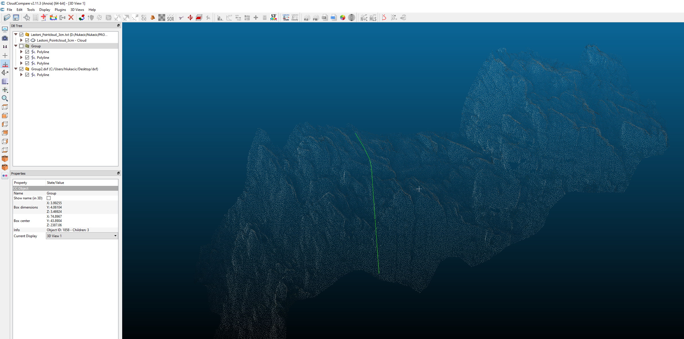

I draw three "Trace a polyline" and joined them under the same group. Then I tried exporting them in two ways: first click on the Group and Save - dxf and it only shows the last polyline in the DB Tree. Second, I did not join them under the same group but only selected them with SHIFT and Save export as dxf and the same problem occurred. I am using CloudComapre v 2.11.3 (Anoia). Every saved dxf file as the same size of 7 KB which means there is only one polyline saved inside it.
I am sending screenshots.

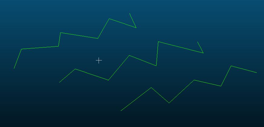

I couldn't reproduce the issue with version 2.12.beta at least.
I trace 3 polylines, save them to DXF, then load them again: The file size is 9Kb.
Can you try with version 2.12 if possible? And if you still have the issue, can you maybe share the polylines (as a BIN file) with me? (daniel.girardeau [at] gmail.com)

Thank you for your help! It works on 2.12. beta
