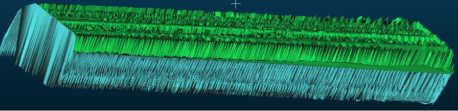

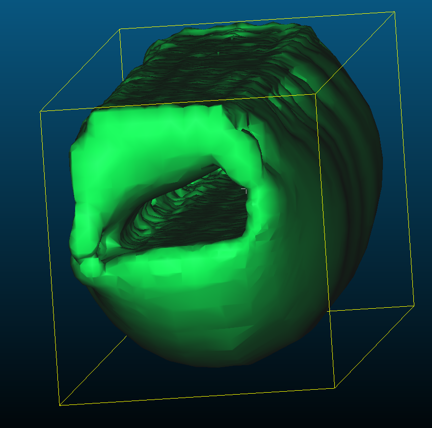

These are the results.
How can I do it cleaner?
If you have any suggestions I would be glad to listen
- haritaforum.png (55.82 KiB) Viewed 36639 times
- meshbest.png (253.74 KiB) Viewed 36639 times
- meshxy.png (472.06 KiB) Viewed 36639 times

Re: point cloud to 3d model
Delaunay is usefull for more "planar" stuff like the ground seen from an aerial scaner.
In your case I would say the Poison Surface Reconstruction may be the tool you need.

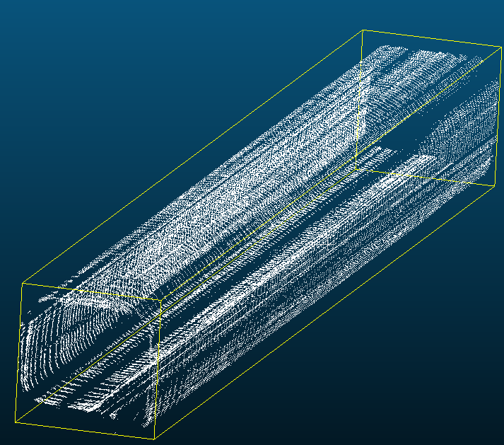

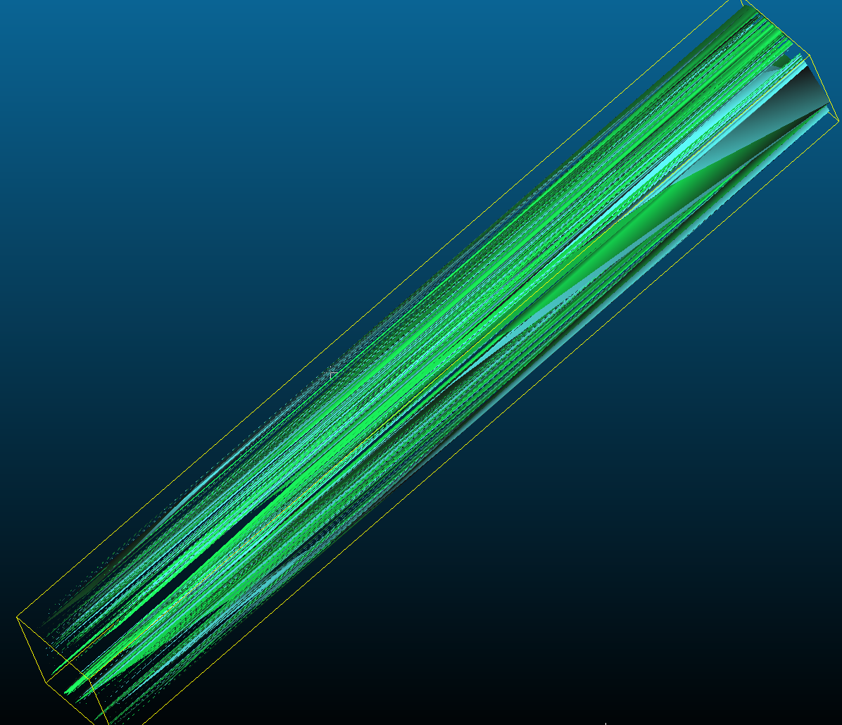

These are the outputs. Is it all I can do about them?
I mean is there any way I can clean them?
- 1.png (303.61 KiB) Viewed 36625 times
- 2png.png (381.83 KiB) Viewed 36625 times
- 3.png (102.4 KiB) Viewed 36625 times
- 4.png (32.94 KiB) Viewed 36625 times

when you perform the Poison Reconstruction make sure the octree is the highest value you've since your cloud is not very dense.
If still the output is bad, I would say is the max you can do. At least that I'm aware of. May be there is a way to fit planes since your geometry is rather planar, but I'm not used to do so.

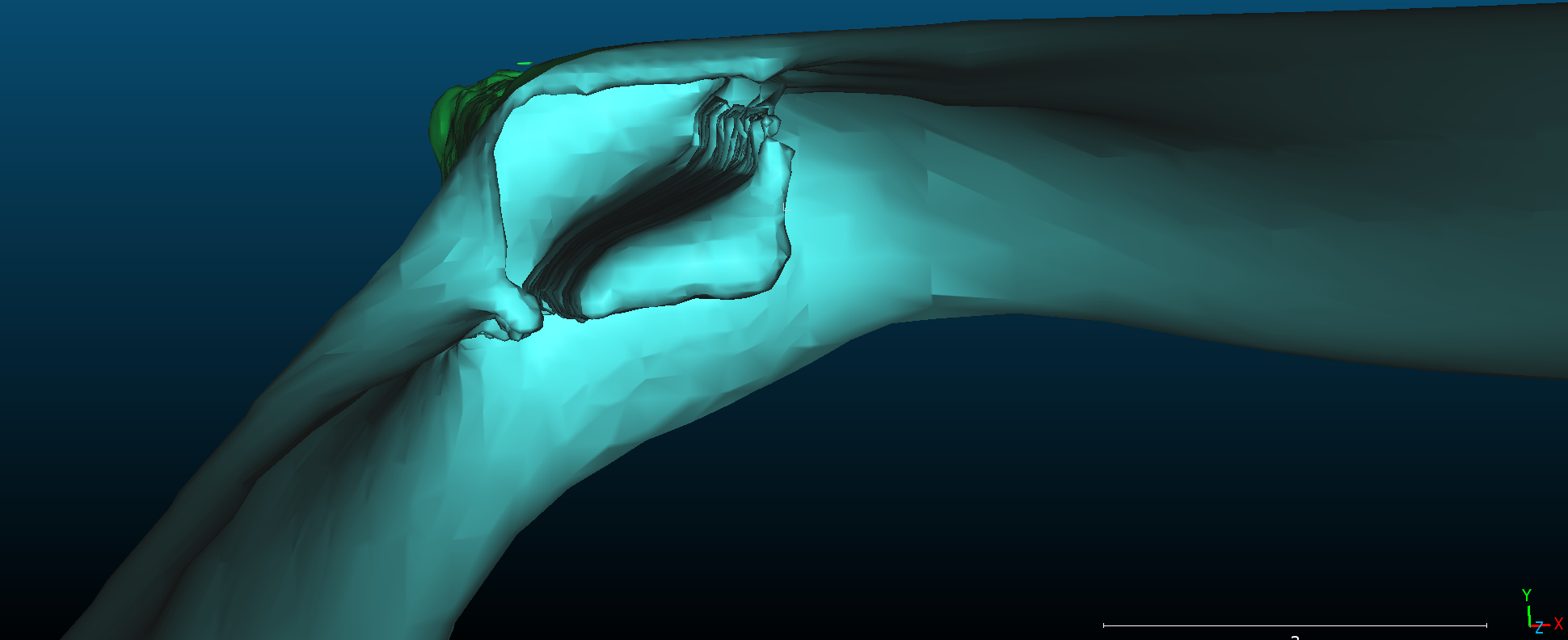

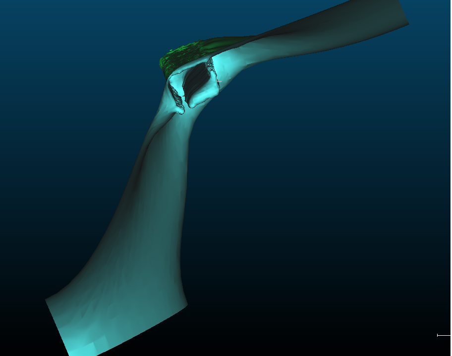

Hi dear friends
The helicopter blade deforms during rotation and I want to model the structure of the deformed blade.
in other words, I want to estimate the model for the deformed blade shape by using the 48 3-dimensional points. Modeling with the NURBS method had a high error because the sampling density of points was very low.
What modeling method do you suggest for my data?
Use CC poisson reconstruction then clean with Blender software ...
Can you attach your pointscloud here in zip file?
