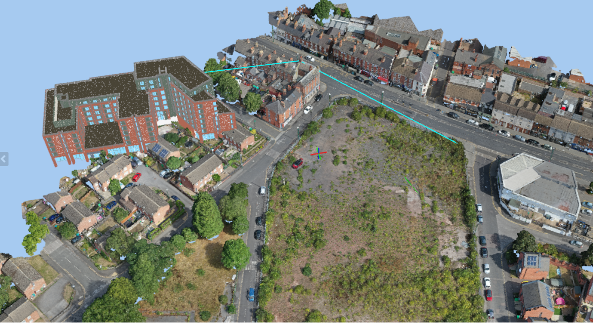

And I've been working on exactly what you've suggested, the OBJ won't export in real coords, so I've been trying to figure out how to apply the translation/rotation required. I have the Eastings and northings from Revit, and I've applied the 'global shift', which gets me close (see attached, I'm overlaying a sampled revit model on a georeferenced survey, the cyan line is an indication of where it should be) but there still seems to be an issue with 'project north' Vs 'True North', i.e. it seems to be out by the 46 ish degree difference. I've then tried the translate/rotate tool which has moved it, but not to the right place. I'm not sure if the point around which I'm rotating (in z axis) is the point I think it is, i.e the revit base/survey point
It's simple enough to find coords on the model in the location I want it, say three corner points of the roof for example. Can you point me towards an easy way of 'applying' those coords to my non located file? (I feel like this is basic stuff in CC but, again.. beginner, any help will be massively welcome)
