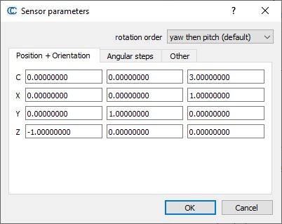

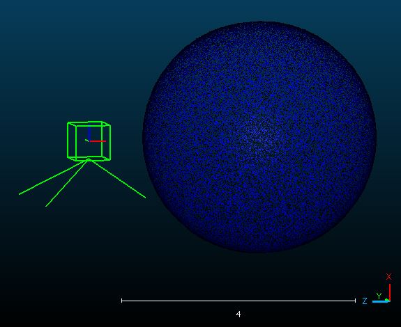

1) Mind that the sensor is looking towards its own 'X' direction (red), so you have to set the right orientation to the sensor so it looks towards the sphere:
2) A sensor created manually will automatically have their 'min' and 'max' angles set so that all the points of the associated cloud are visible (they can go up to 360 degrees, as some real scanners do).
3) By positioning the sensor outside of the sphere (0, 0, 3), I'm not sure why you were expecting to have points with negative z values (even with respect to the sensor)
All in all, I'm not sure you'll be able to achieve what you are trying to do this way? The 'HPR' plugin might be helpful though (see https://www.cloudcompare.org/doc/wiki/i ... l_(plugin)). You can create the sensor, apply its viewport (with its 'Apply' button in its properties), then select the cloud and run the HPR plugin).

@daniel : yes sorry about that, the orientation was indeed not good. So now my position and orientation matrix is the same as in your message.
But when I compute visibility, I get only the value 4 (out of fov). Shouldn't it be 0 (visible) for points on the sphere with positive z coordinates (they are in front of the camera), and 1 (hidden) for points on the shpere with negative coordinates, as they are hidden by points with positive z coordinates?
