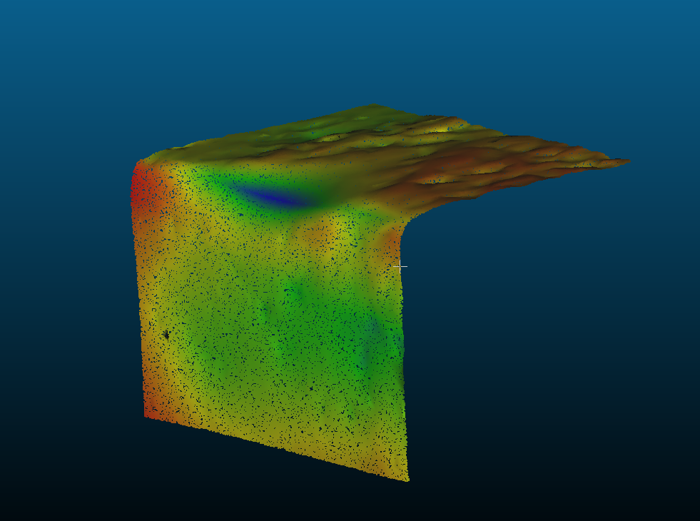

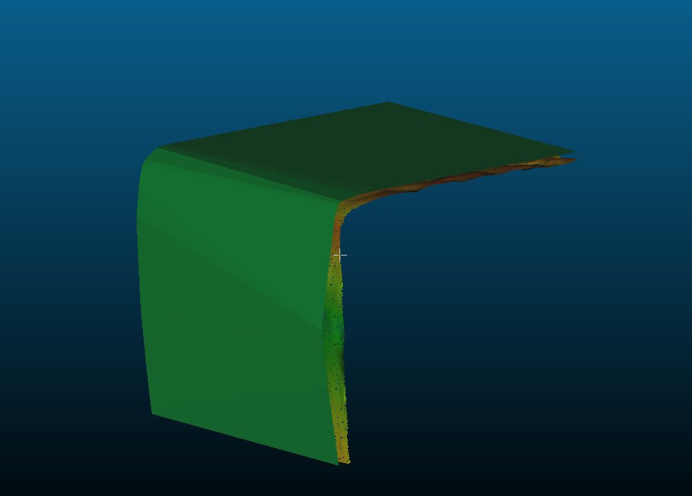

Hello! I was wondering if there is a method for calculating volume only use the signed differences scalar field. I have a point cloud representing a fairly uneven and curved surface. I created a convex hull of the cloud and calculated the distances between the two. I would like to calculate the volume of this gap, but only for small sections of the larger cloud / convex hull assemblage. There are holes between the convex hull and cloud because they are cut out of the larger models. I used Poisson Reconstruction to create a solid mesh to use for volume calculation, but this creates strange artifacts and is more labor intensive. It would be great to simply use the scalar field. I've attached a photo to show the cloud surface with the scalar field, and another with the cloud and convex hull section.
Convex Hull mesh overlaid on cloud
Screenshot 2023-02-09 143904.png (31.44 KiB) Viewed 9731 times
Cloud with C2M scalar field
Screenshot 2023-02-09 143752.png (239.06 KiB) Viewed 9731 times

Sadly it's not possible in an accurate way.
The M3C2 plugin tries to estimate the volume (I believe in the console) at the end of the distances computation, by summing the individual volumes of the core points search cylinders (= scale as radius * distance as cylinder height). But still, the result is approximative as it depends on the cloud sampling.
