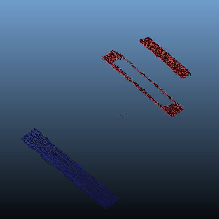

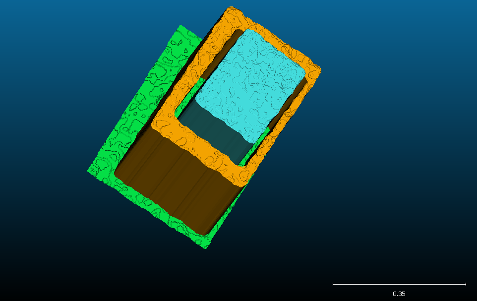

Hi
I am attaching the point cloud data for which i need to calculate volume. I have tried forming mesh for the data along with ground cloud merged with the object ground data. The mesh formed resulted in gaps. The volume computation is inaccurate.
Since the forum doesnt support upload of .pcd and .obj data am attaching the screenshot of those file. The aim is to create closed mesh with the given point cloud data and should calculate the volume for the mesh.

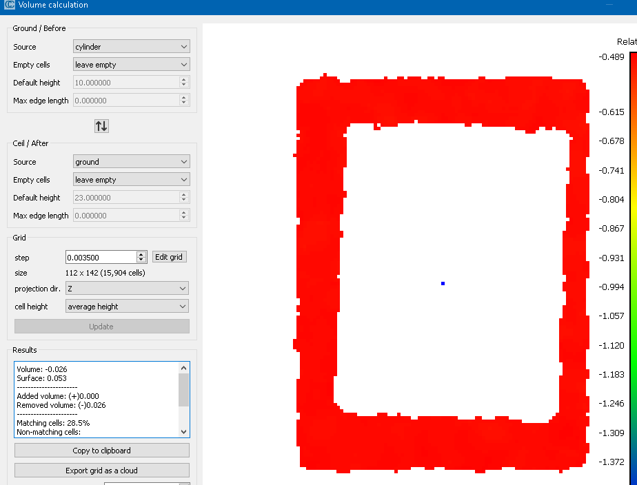

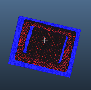

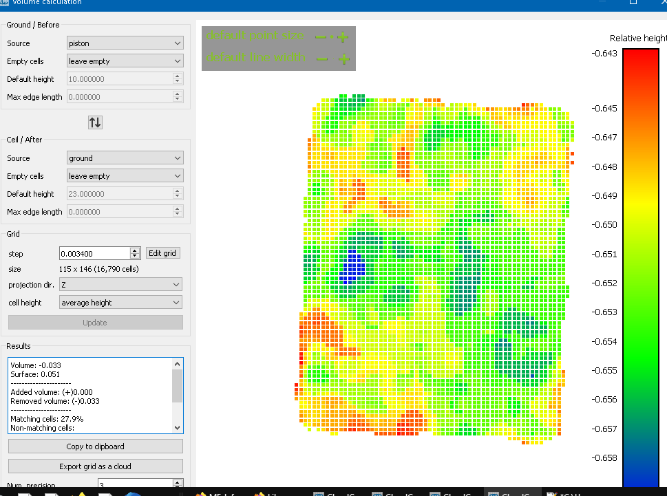

Re: MEsh formation in Cloud Compare
If this is your actual shape
1- Your 3 pointscloud is dense so 2.5d volume tools can find volume to ground (must segment each one)
2- Meshing is possible by CC but processing in BLENDER (extrude to almost ground .. etc)
. SO
============= CYLINDER 2.5d volume ================
Volume: -0.026
Surface: 0.053
Added volume: (+)0.000
Removed volume: (-)0.026
Matching cells: 28.5%
Non-matching cells:
ground = 0.0%
ceil = 71.5%
Average neighbors per cell: 7.5 / 8.0
============= PISTON 2.5d volume =============
Volume: -0.033
Surface: 0.051
Removed volume: (-)0.033
Matching cells: 27.9%
Non-matching cells:
ground = 0.0%
ceil = 72.1%
Average neighbors per cell: 7.8 / 8.0
Edit ---> Mesh ---> Measure Volume
[21:49:39] [Mesh Volume] Mesh 'piston': V=0.0326455 (cube units)
[21:49:52] [Mesh Volume] Mesh 'cylinder': V=0.0244805 (cube units)
find atatched bin file in 7z file (archive)
