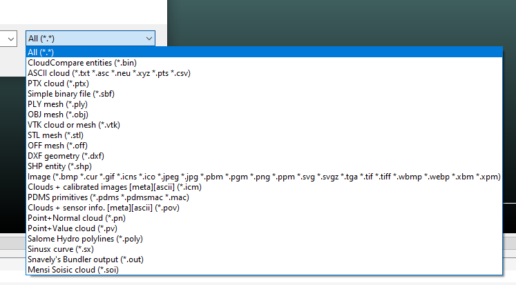

Hey, thanks for your answer. Unfortunately my problem is, that somehow the plugin is not "activated" or i don't know. It's not like CC crashes when trying to load an E57 file, it simply doesn't offer the option to do so:
It does not show the plugin in the plugin manager, but the other plugins work fine:

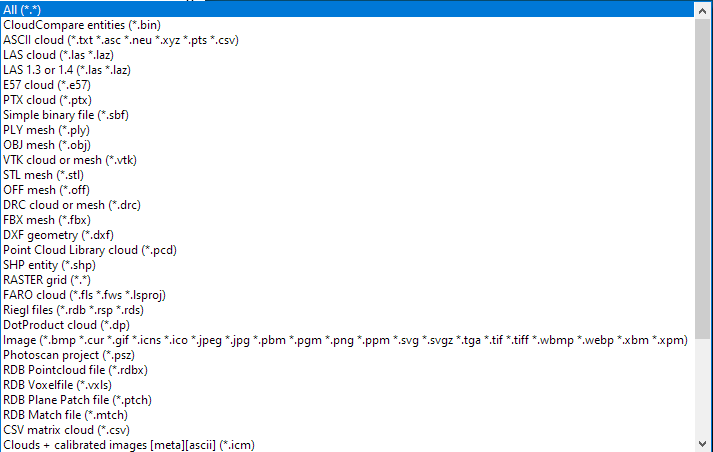

I'm using the Windows .EXE, its appears that E57 is not the only format that is missing from your list.
CC import.png (17.61 KiB) Viewed 139550 times
